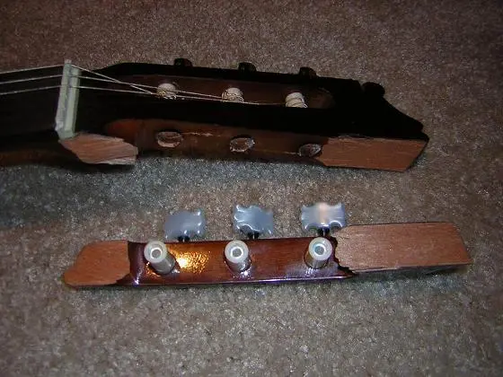

I am a moron. I am not going to reveal how I managed this because I value you guys' respect. Anyway my headstock on my classical is broken in half, pretty much right down the middle. One side of it with it's tuners broke clean off. Can this be glued? Repaired? Give me the truth, I can handle it...

Can you post pics, or email them... I might be able to take a look at it and give you some pointers
headstock pic
From the picture I'm looking at, you lucked out BIG TIME! Easy repair. I would still have a good luthier do the job, but in the end you probably won't even be able to tell. I must admit though, I've never seen one break quite like that.
Like Clive said, I would definitely pay to get it done. Make sure you check around first though for different prices of repair costs and make sure you see each person's work before you decide to go with them. Try and find a guy who's dealt with something like this before.
