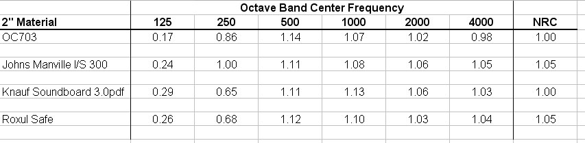

Are any of you guys familiar with the Knauf or Johns Manville rigid fiberglass products? I'm comparing the sound absorption coefficients from each of the product data pages...

All of them have similar density products with similar sound absorption data- OC703 is 3pcf. The JM and Knauf products seem to be less effective between 250 and 500.
I found a local dealer willing to order small quantities, and even better, he said they'd get get most stuff within a couple days... I haven't got costs on any of them yet. when he said it might be easier to get JM, I thought I'd look it up first. I know they stock the Roxul rockwool.
The Johns Manville stuff actually looks like the best performer. The question is,are there any other considerations other than the sound absorption that I'm missing?
I've used the Roxul stuff extensively when I originally treated my basement "studio" about 6 years ago. So, I know that stuff works. I also used some OC703 that I came across, and that seemed easier to work with.
I'll be using this for the standard corner traps and wall panels.
Any input from the local pro's would be awesome. I'd love to make my order tomorrow so I can try and get this stuff by the weekend.
