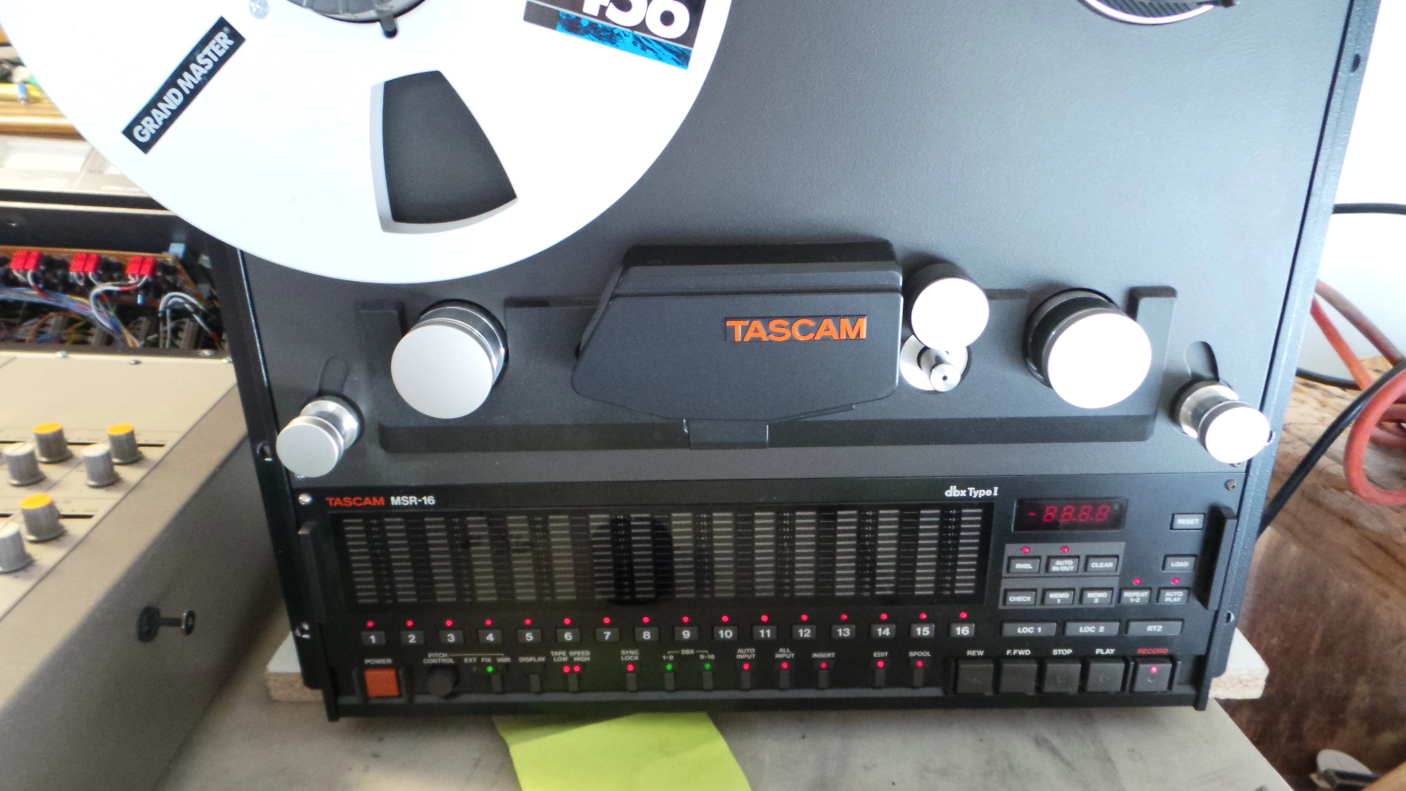

I've determined this so far. This machine powers on a few different ways.
1. Semi normal as far as the control board lights are concerned. They all flash the red color (exception, vari speed amber) as shown in the picture I provided. then settle down to the Same..as shown in the video I posted.
2. The two leds at the (Pitch control) light Amber/red at the same time. Then, the speed (low) led lights together with the counter display.
3. The two leds at the (Pitch control) light Amber/Red at the same time this time the Tape speed (low) led does not light... also it is connected to the Counter display as it also does not light. I did notice in darker situation. There was a (very dim) flashing in the counter display in this state.
In all three situations, the capstan only runs when the right tension roller is raised. The reel motors turn in all three instances.

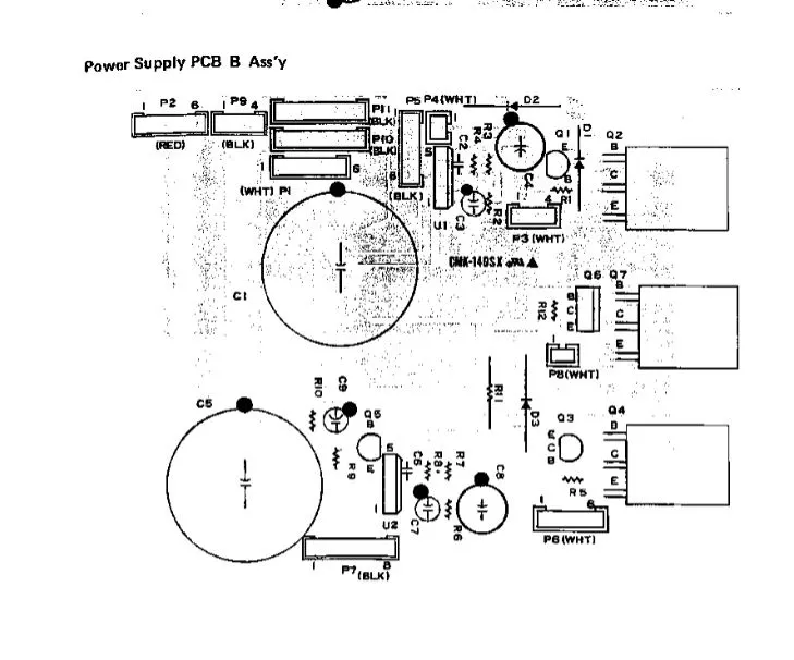

I don't know where to test the power supply. This unit seems to have two PS PCB's.
It continually powers on like these. What determines which on I don't know.

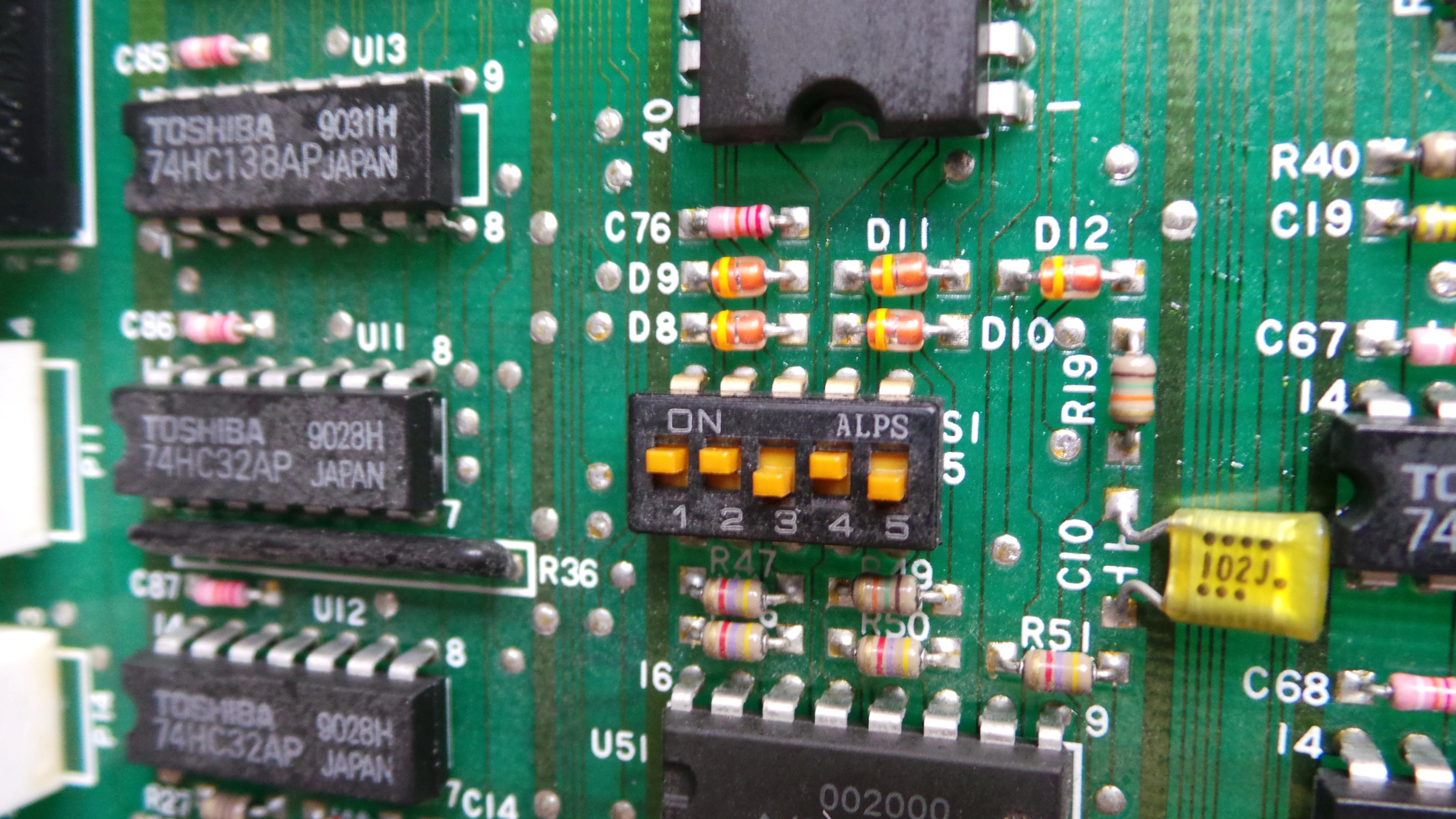

Couple of things. Are these the same? What is this? Could I have inadvertently changed this? What would it matter?

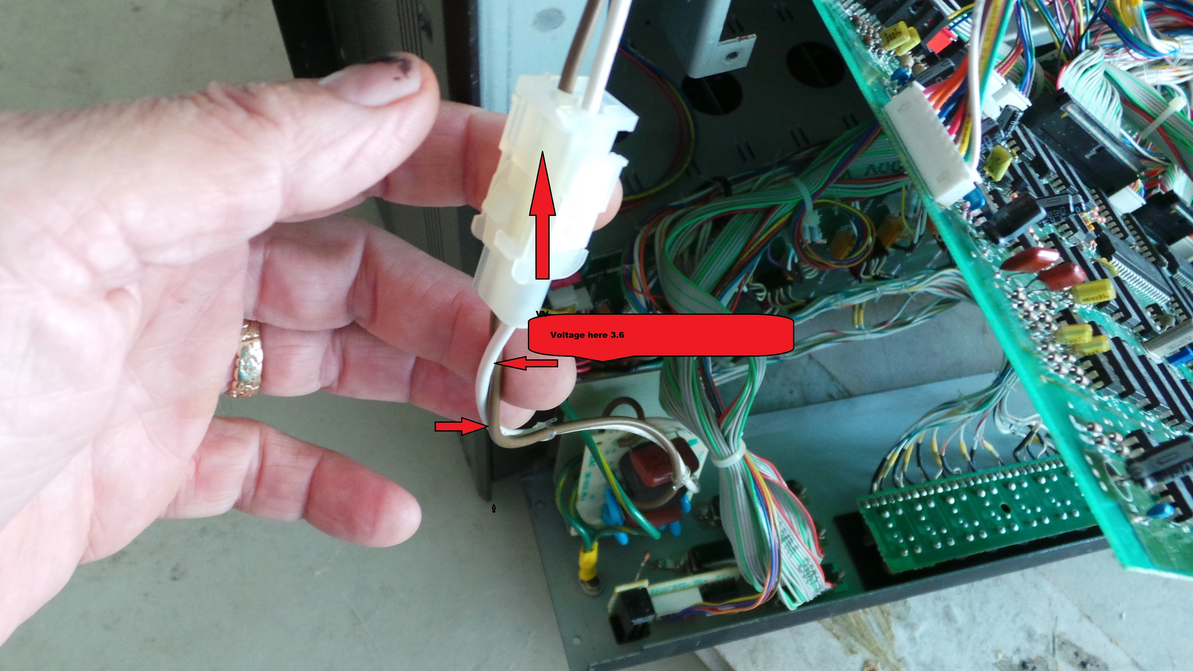

I checked this. The arrows show power travel from plug on rear of machine. It looks to be the first point of power to the Unit.
