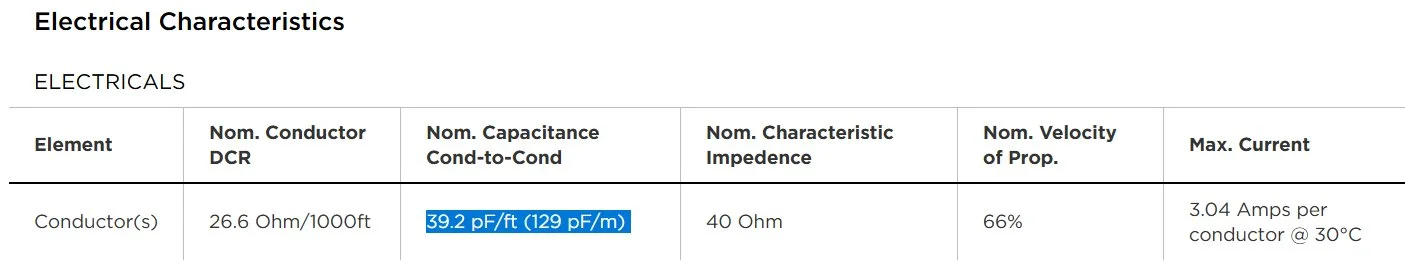

Here's the spec for Belden 1192 star quad microphone cable. Notice the conductor to conductor capacitance value of 39.2pF/ft. The longer the cable, the higher the resistance, and the higher the capacitance. It really comes into play when you have a high impedance signal to start with. That's why you don't want to use 50 ft cables on your guitar, the capacitance will change the tone, just like a tone control.
interesting, note its pF...pico farad.
guitar caps are micro farad.....it seems from a quick google search.
micro is to the 10-6 and nano -9, and smaller yet is pico 10-10....so I wonder what pF/ sounds like to the human ear?
Ive worked as a grunt in micro-electronic device factorys, now often called nano devices, the rave as in smaller=better, with pico going into DNA size down the hall at the bio engineering lab.....lol
pico farad, wow...
we are talking so small visually measured by some tool but here we are concerned with sound and freq of a signal to our ear not electrical oscope values.
