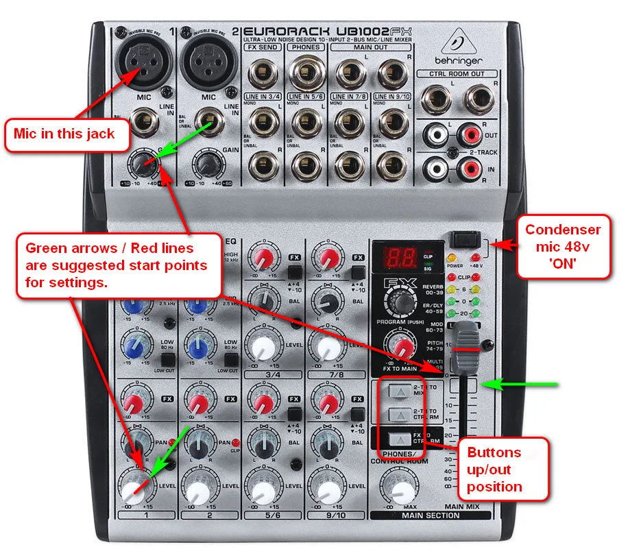

Possible start setting points. If using a dynamic with a Cloudlifter, FetHead, or other similar gain boost dvice, 48v phantom needs to be 'ON'.

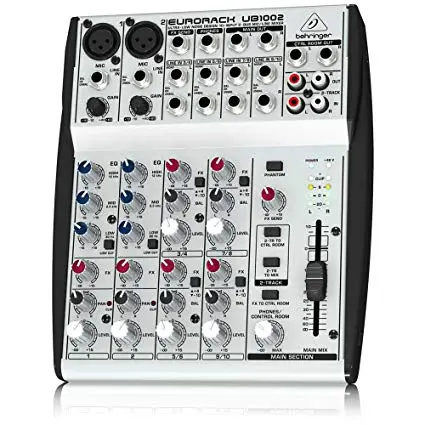

The mixer I have looks like this (I gave the wrong version of the mixer in the description, sorry about that - it is the UB1002 Xeynx):
I am wondering if there is something wrong with the actual mixer because of this. Power is flowing through it because of the Phantom power working, but the POWER button and LEVELS (when using the mic, screaming into it ) do not light up.

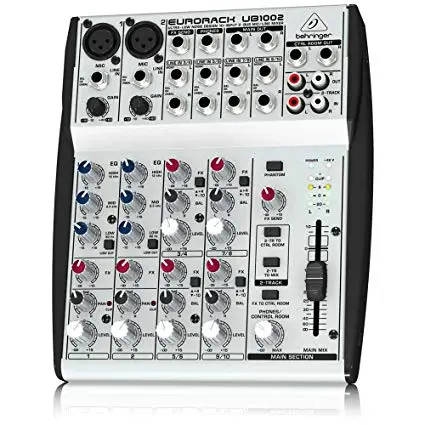

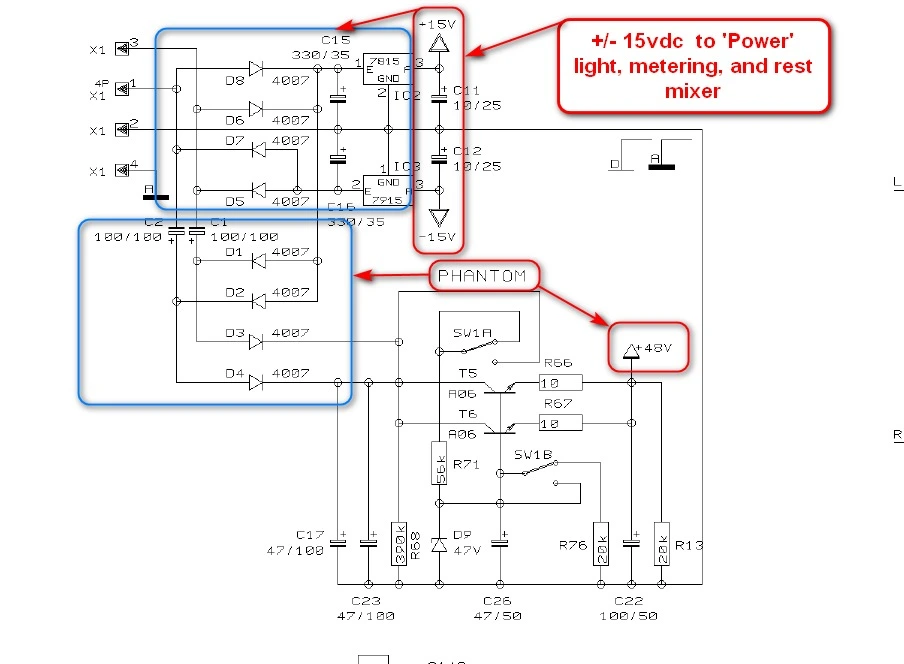

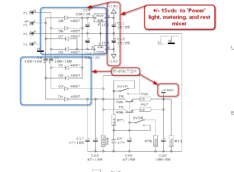

Off hand looking at the service manual for the mixer, part of the internal power supply section in the mixer may have a problem. The light for the +48vdc phantom power is a different circuit than the +/- 15vdc power for the power light and the meters. I would believe the +/- 15vdc power section has a problem since the power light doesn't come on.

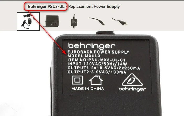

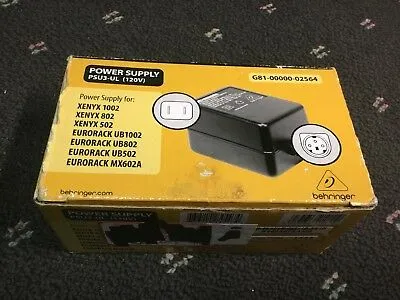

The power adapter you bought is the Behringer PSU3-UL?

so that means short of opening it up and looking for dead circuits, this is a non-starter?

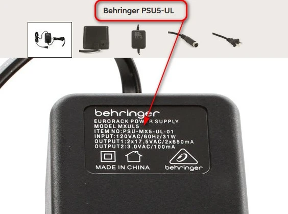

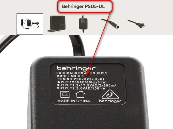

Sweetwater sells the OEM power supply that does have the MXLU5 number.
Behringer PSU5-UL | Sweetwater
......but it's not the PSU3-UL??????
Found a pic of the power supply box that shows UB1002 and PSU3-UL, so those should match up OK

the 5 puts out twice the amps as the 3
could that be the problem ?

Smaller mixer needs less amps and the pic of the Behringer PSU3-UL box shows the mixer the OP is using. You can always use a higher capacity power supply which is what the manual conveyed.
I have a feeling the OP got the replacement power supply thinking there was something wrong with the original with the problem he has.
"the behringer docs dont even have any pictures of the i/o or power connections"
The schematic I showed a few posts back has the pin numbers for the incoming plug/socket.
"Output 2" is 3vac. I've seen it speculated that was possibly for an accessory lamp for the mixers.
