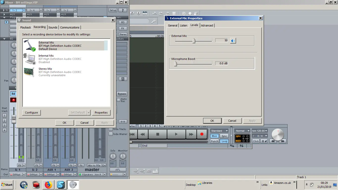

How long have you had the microphone? I ask because you may have got a faulty one. The NW-800 belongs to a family of very cheap capacitor mics, I have had two of the BM-800 variant (they will tell you here I am bit of a go-to guy for the bottom budget dept!) and I was lucky, they performed remarkably well but I have seen several posts where is was pretty plain that people had bought a "lemon". Not bad for the money at all but QC suffers.
You have Win sounds set to 100%. I think that is too high but I will dig out my BM and check. However, your setup is rather different from mine. I think you have an XLR cable from 48V supply to mic then an XLR to stereo 3.5mm jack to laptop? If so you are relying on the PC's mic amplifier. In this HP i3 laptop that works well with the BM-800 but there is no power supply with that, it run from the DC put out by PC soundcards. The BM can also be used with an XLR-XLR into an audio interface and I have done that as well and it works ok.
So, bottom line. You could have a particularly noisy laptop pre amp but my money would be a very low sensitivity mic sample. Can you try another computer? Also it would be wise to check that the power supply really does put out 48V.

The mic is plugged into the 3.5mm 3 pole jack on this i3 HP laptop. The noise level is about -60dBfs and that includes mic self noise, HP preamp noise and ambient noise in the room at 8:30am today. For a £25 microphone I think that is quite remarkable.
If you want me to I can do a similar recording via XLR and my NI KA6 interface. The noise level of that is way below -60 and so would show just the mic's self noise+ambient. It is a "gift" to today's home recordists that AMBIENT noise is usually the limiting factor even with dynamic mics.
