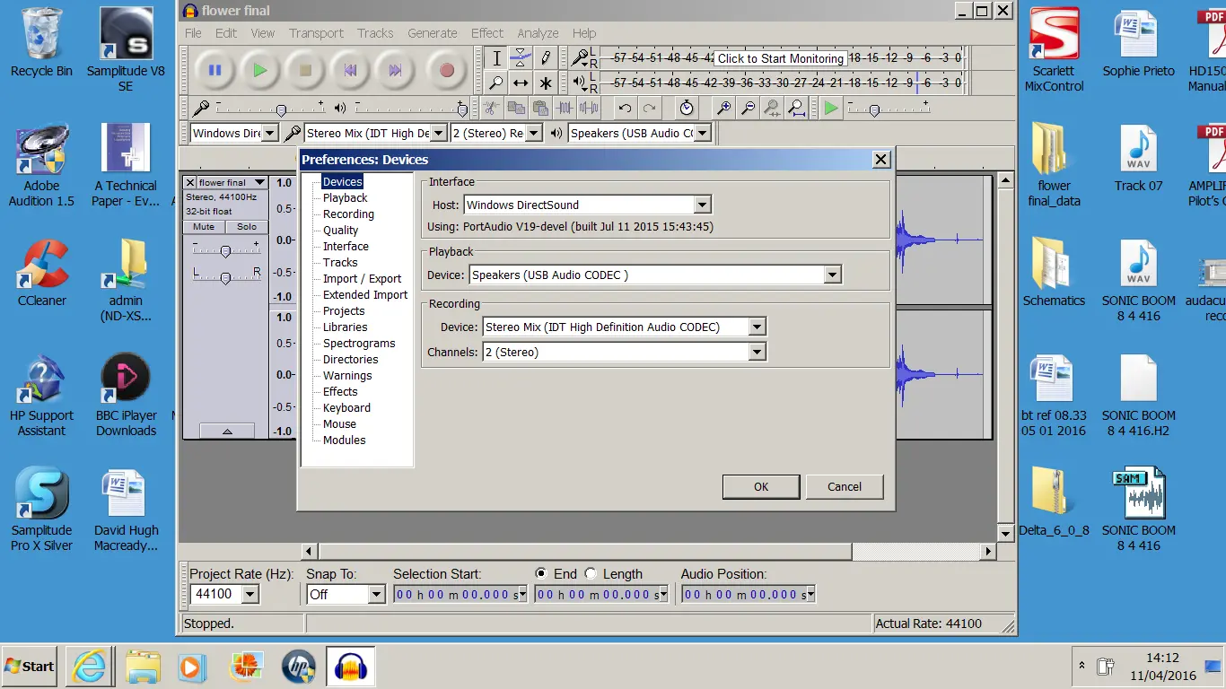

That said, when you say 'select device' do you mean under Host? Because I'm not seeing anything USB flavoured. I have std Windows options - NME, Direct Sound or WASAPI
Attached is how my UCA 202 (which I suspect is the USB "works" of the Berry mixers)
is setup on this HP i3 laptop.
In Windows (7) Sound Menu the record default is set as "External Device IDT HD CODEC" (N.B. no mention of USB!)
The playback device is, "Speakers USB Audio CODEC."
Hope that helps?

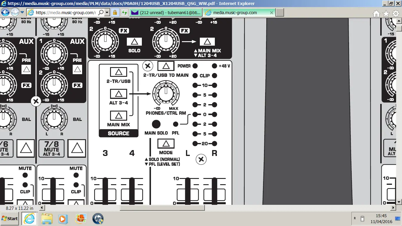

You need the amp fed from the RCA line outs of the mixer or possibly the Main Outs.
I will look for a signal diagram for the mixer.
See if attached helps.
