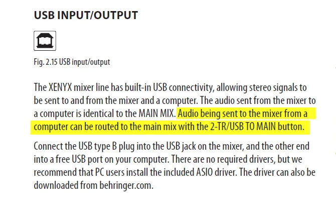

And from the manual, there is a button to select the USB routing from the computer to the Main Mix.
I believe the Main Mix should be heard in the headphones when this button is depressed > '2-TR/USB to Main'

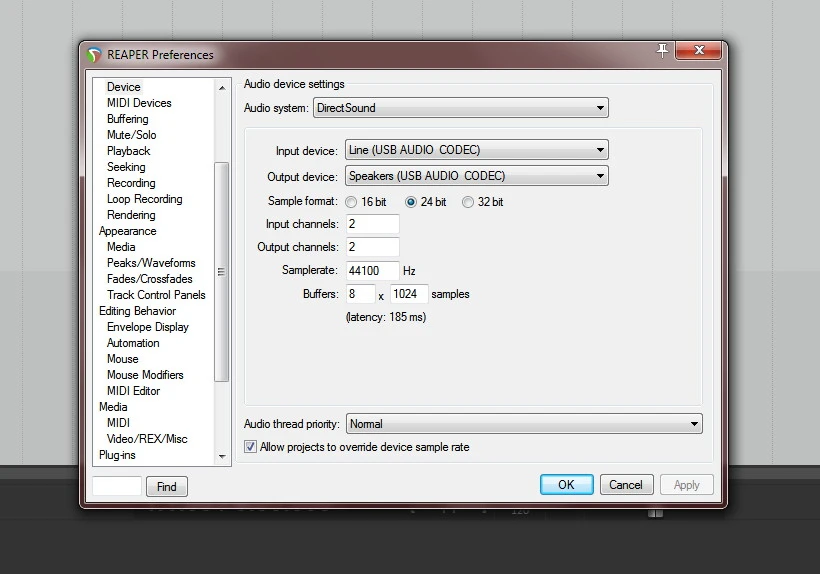

I did not have to change anything in the Windows sound menu for the same mixer the OP has, only in the DAW where as you said it was something like 'USB CODEC', but not knowing what the OP is using for streaming perhaps he may need to go in and tweak the Windows setting. Reaper shown below with the Xenyx 1204USB connected up.
I may do things a bit different than most here. Rather than use an interface for all sound in and out of the computer, I still use the PC's soundcard with the Reaktek system for playing of most all music from Windows Media player as well as the VLC video player. I only use the interfaces for recording and most playback into Reaper or Audacity, but may switch to the computers soundcard at times for playback from those programs. A few here have reported occasional conflicts doing it this way, but I guess I've lucky thus far.
