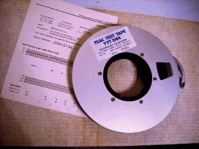

This seller has a TEAC YTT-1144 calibration tape -- very hard to find. These tapes used to cost hundreds of dollars new when they were available.
http://cgi.ebay.com/ws/eBayISAPI.dll?ViewItem&item=290004829091
It says, “Free shipping” in the text of the listing, but has a shipping cost where eBay lists shipping. Grab it before he changes the text! :D (he probably just forgot to zero the shipping from a previous listing... ebay saves it).
It will work on everything from the TEAC 80-8 to the TASCAM MSR-16, Fostex B/E/G 16 models and Otari MX5050/8… anything ½”, 15 ips with IEC equalization.
This is nearly identical to MRL 31J229, which is currently $210.00 new.
Here’s the rub… from the serial number it has to be from around 1980. This means a likely sticky-shed issue. However, this is one area that baking a tape for current/future use makes sense. Once it’s restored it will work properly. In a home/project studio you won’t need to check your machine more than once a year. Even if you have to bake this tape 4 hours once a year this is a good deal.
I bought one of these dated 1981 out of curiosity some time ago. I baked it in my Snackmaster dehydrator and it worked flawlessly. My TSR-8 was setup with a new and very pricey MRL calibration tape, but when I checked it with my 25-year old TEAC tape it was dead on perfect.
So if you’re on a budget and have discovered the joys of baking, this might be something to consider. :)
What kind of hub is that? It doesn't look like it has the regular center hole.
That’s just the aluminum center of the box. The tape has a standard NAB hub like you get with current Quantegy tapes, but the reel is only 8-inches in diameter, which also makes it look different.
Here’s a better picture with the hub moved off of the center holder.
Ohh, OK ;)
