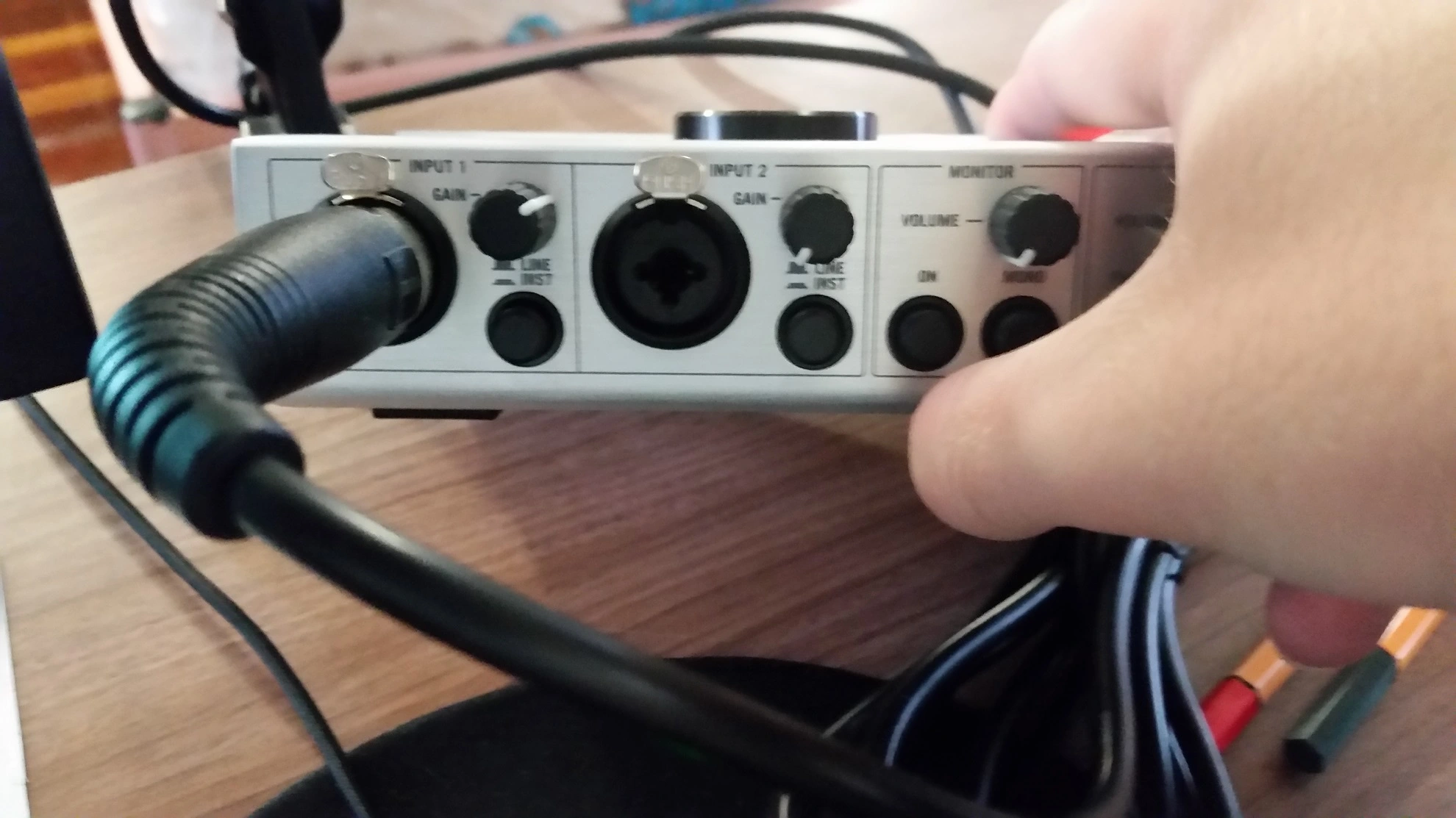

It's connected over xlr from the mic into the tlr socket of the audio 6 with the other xlr end, so yes. I recorded in mono but there is a print around the rim of the microphone that said Stereo. I tried talking into every side except the one facing back which is adjusted towards the backside.

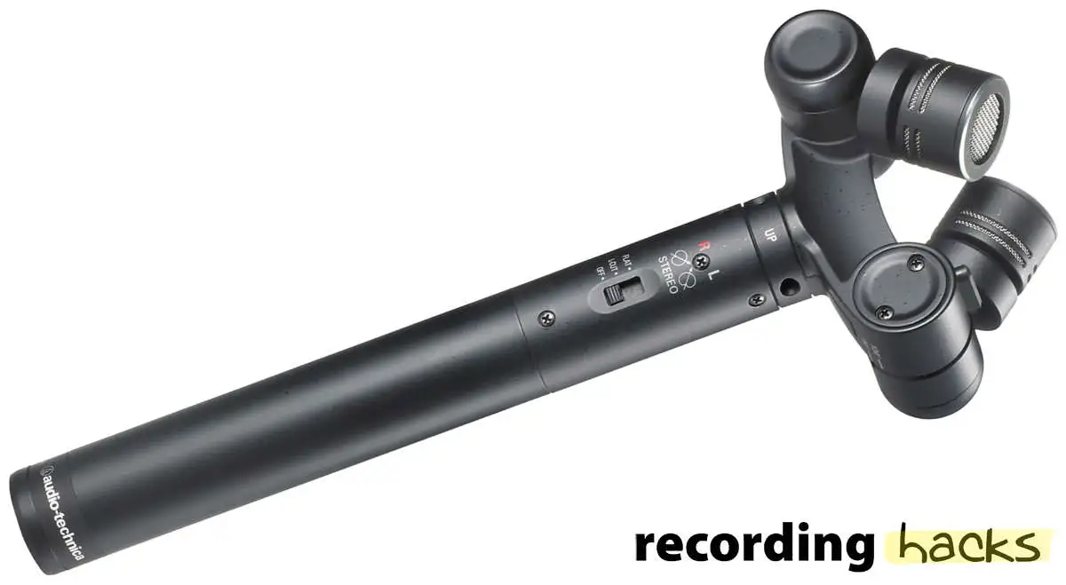

Is there a really, really remote chance it might be an AT2022 x/y Stereo condenser mic shown below which does have 'Stereo' imprinted near the top.

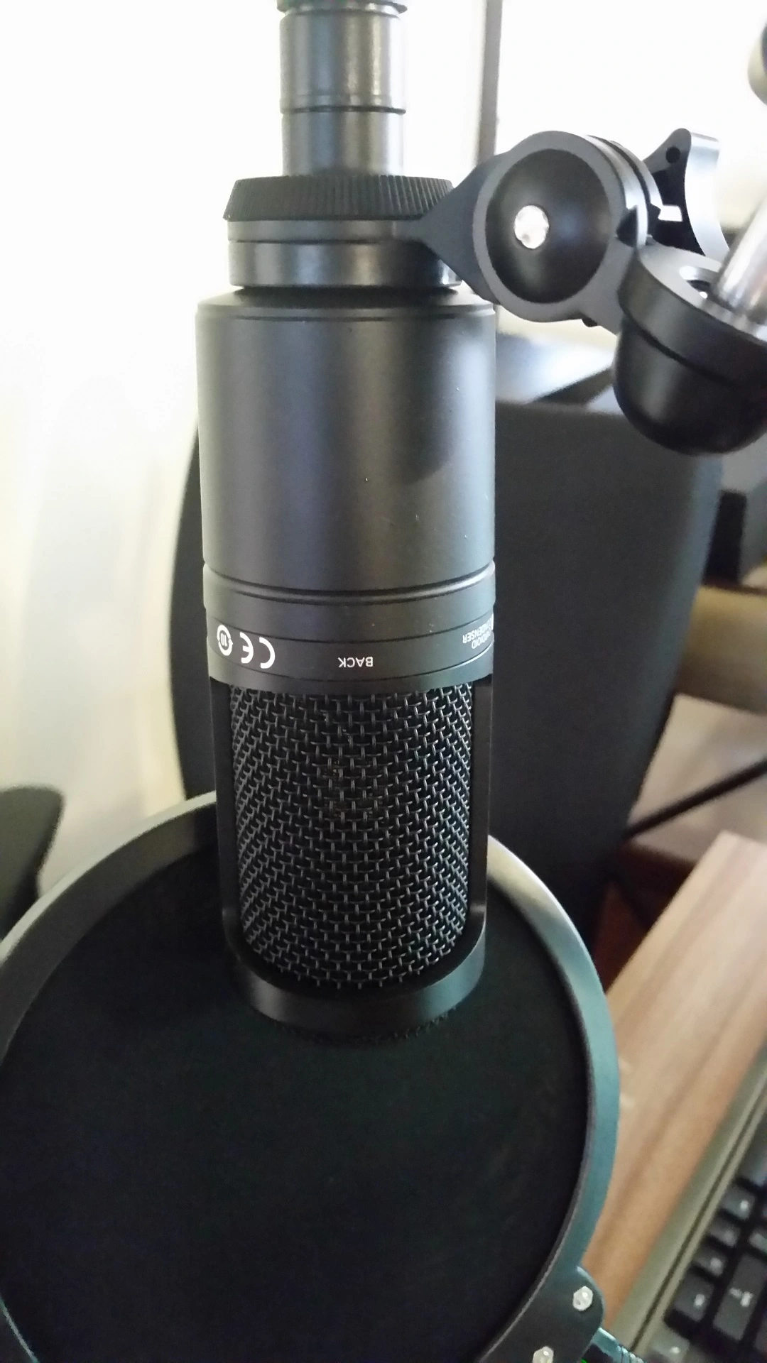

"I tried talking into every side except the one facing back which is adjusted towards the backside."
- This got me wondering if it was an AT2022 when you mentioned "the one facing back which is adjusted towards the backside". I couldn't see how you might 'adjust' an AT2020 or I'm confused :) .
"It's connected over xlr from the mic into the tlr socket of the audio 6 with the other xlr end, so yes."
- 'tlr socket' - I'm not sure what 'tlr' is. The KA6 has a 'combo' jack that accepts XLR and 1/4" plugs, but I've not heard it called 'tlr'.
If is indeed an AT2022, it very well could cancel out close sounds if connected to just a single input of the interface by XLR, but possibly pick up a far away transient sound such as a key dropping.

"Is there a really, really remote chance it might be an AT2022 x/y Stereo condenser mic shown below which does have 'Stereo' imprinted near the top."
No, there is not. In my post above I already said that it's my bad, I must have seen it somewhere else with the Stereo. It is for sure an AT2020.
I mean I adjusted my Microphone stand which is connected on my desk and the mount on the microphone directly so the print on the AT2020 which says "back" faces directly away from me. I will attach a picture.
The ones on the front, yes the combo jack that accepts both the plugs you mentioned. I grabbed the manual again and saw a mention of the "TRS" jack for the headphones in there. Thats where I got my words twisted. " 1/4" TRS jack headphone socket..."
It is for sure not, no. :)

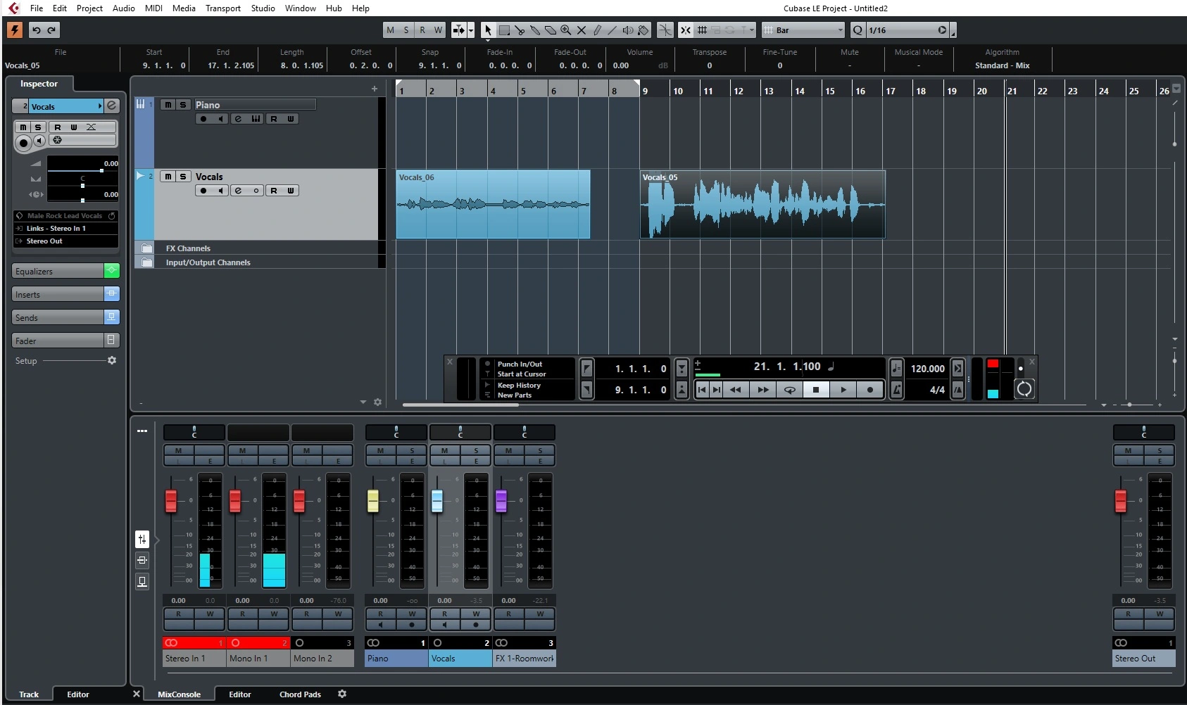

I set up the ASIO of the KA6 in Cubase which I just activated as it wanted me to do it. Here is a Screenshot from 2 Audiofiles. The left one is in a comfortable sitting position like you would make a Podcast, have a Skype conversation, moderate a let's play or all in these regards. The wave forms are there. Hearing them back, nothing at all for the left one. Cubase couldn't pick it up except on one tiny part maybe for half a second or less you could hear something.
The second recording to the right was directly in front of the pop filter in a singing pose. -6DB, no red led on the KA6 and you could hear everything back crystal clear.
In Audacity, no matter what, it doesn't detect ASIO Drivers, just Windows Options and the Soundwaves always look like in Cubase the Left Audio File. I have to boost them to -6DB because the recording is in something of -30 and multiple background noises, which it didn't have in Cubase for whatever reason. I just monitored this with a pair of Sennheiser HD650s.

I'm puzzled by the "stereo in 1" words in the DAW, and why, when the "vocals" track is selected in the track window, I'm seeing two channels selected in the mix pane. You have a single, mono mic plugged into the interface, so it should go to a mono track that is associated with a single mono fader, at least until you start bussing it around. But, that DAW is another I don't know anything about.

I set up the ASIO of the KA6 in Cubase which I just activated as it wanted me to do it. Here is a Screenshot from 2 Audiofiles. The left one is in a comfortable sitting position like you would make a Podcast, have a Skype conversation, moderate a let's play or all in these regards. The wave forms are there. Hearing them back, nothing at all. Cubase couldn't pick them up except on one tiny part maybe for half a second or less you could hear something.
The picture shows you ARE picking up sound, but why can't you hear it on playback? The KA6 is selected as the audio output devce, right? You have the headphones plugged into it, not your computer's headphone jack, right?
Yes it is selected as output device and they are plugged into the KA6. And I have absolutely no idea why I cant hear the left recording but the right one perfectly.
