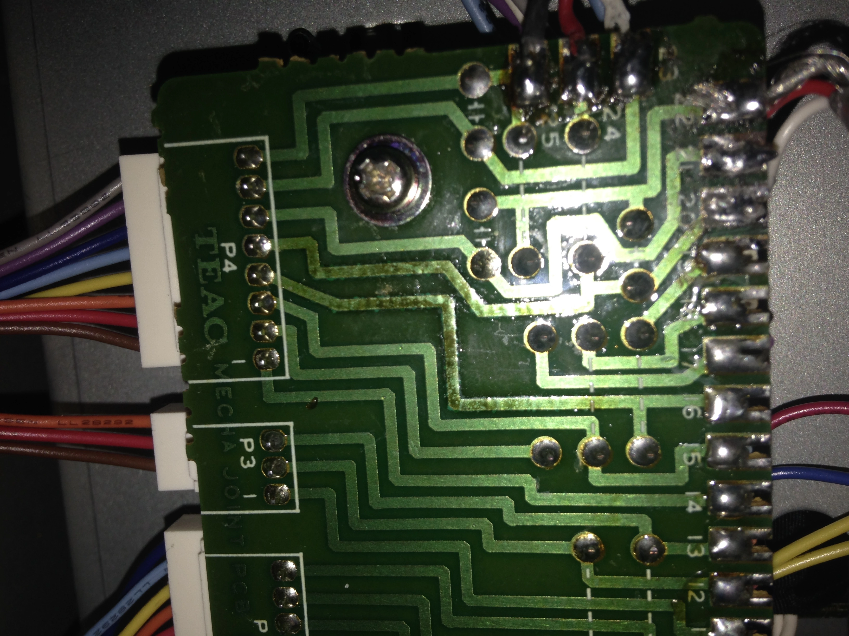

I think i did have it wired the wrong way. I put it around the right way but unfortunately made a big mistake. I had the tiniest most minuscule bridge of solder on the MECHA pcb between points 19 and 20. I was trying to wire the reel motor to 20, 21 and 22. When I turned it on I smelt something burning so immediately switched it off.
I removed the tiny bit of solder bridging the two connection points (19&20) on the PCB. I also replaced a fuse which had blown. The tracers on the MECHA pcb have blackened on the 19 and 16 tracer lines. So now when I engage the transport with tape on, the take up reel spins the right way but only for a split second and then jams the whole thing. When I engage the transport without a tape on, the take up reel table doesn't move except intermittently on FF where it spins along with the supply. The supply always spins. Have I fried the MECHA pcb or could this be something even worse?
So frustrated and angry with myself right now. There's not a lot of light in the room I'm working in so I really should have gone and gotten a lamp to see things better, I knew something like this might happen.
im going to have to repair these tracers... my soldering is bad but it looks really bad in this picture.
