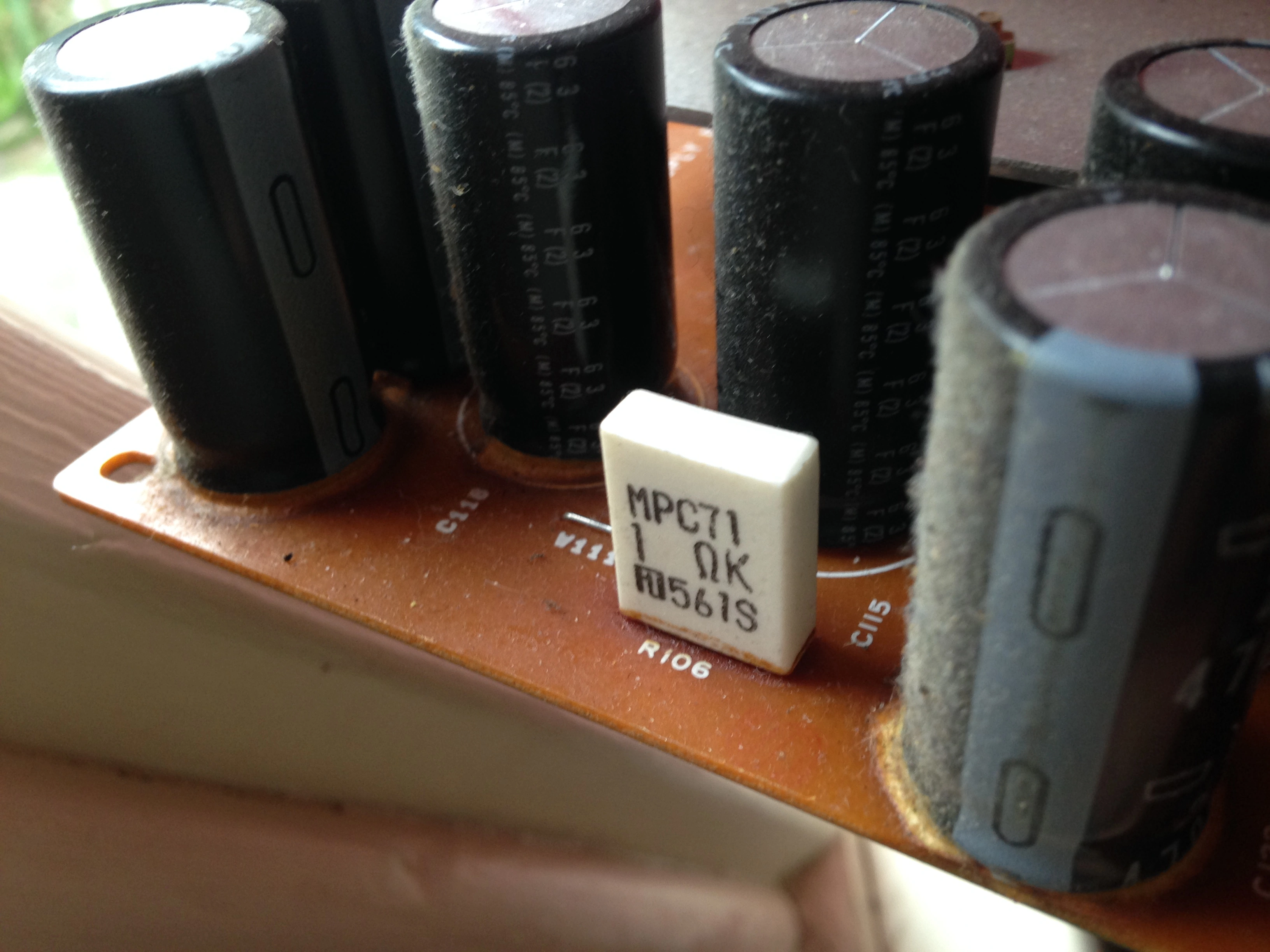

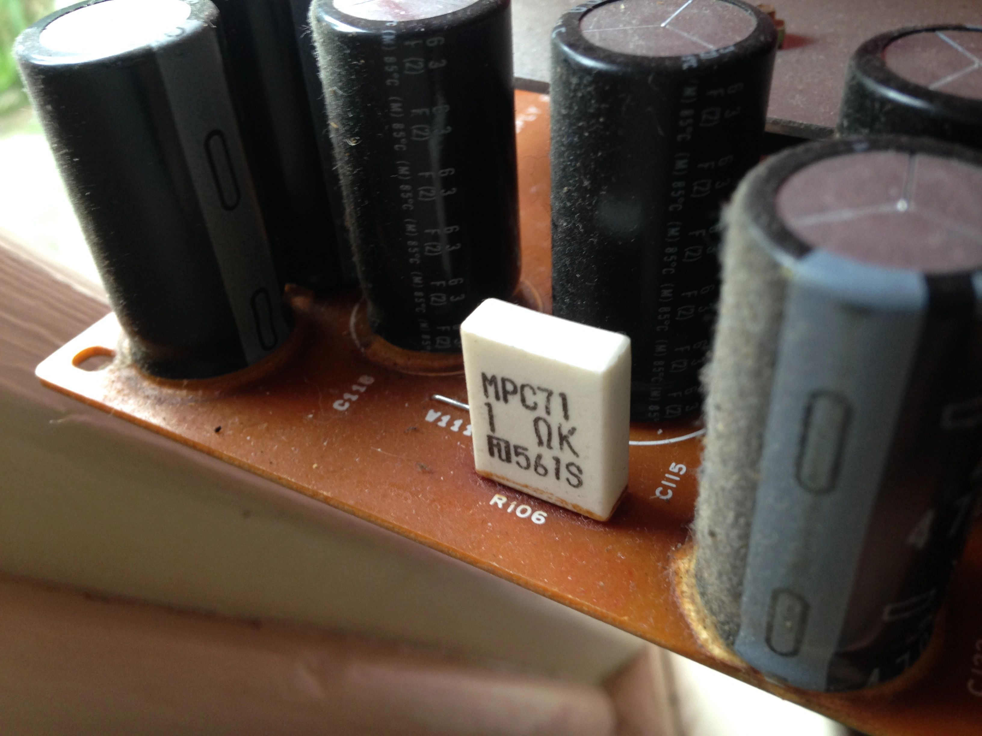

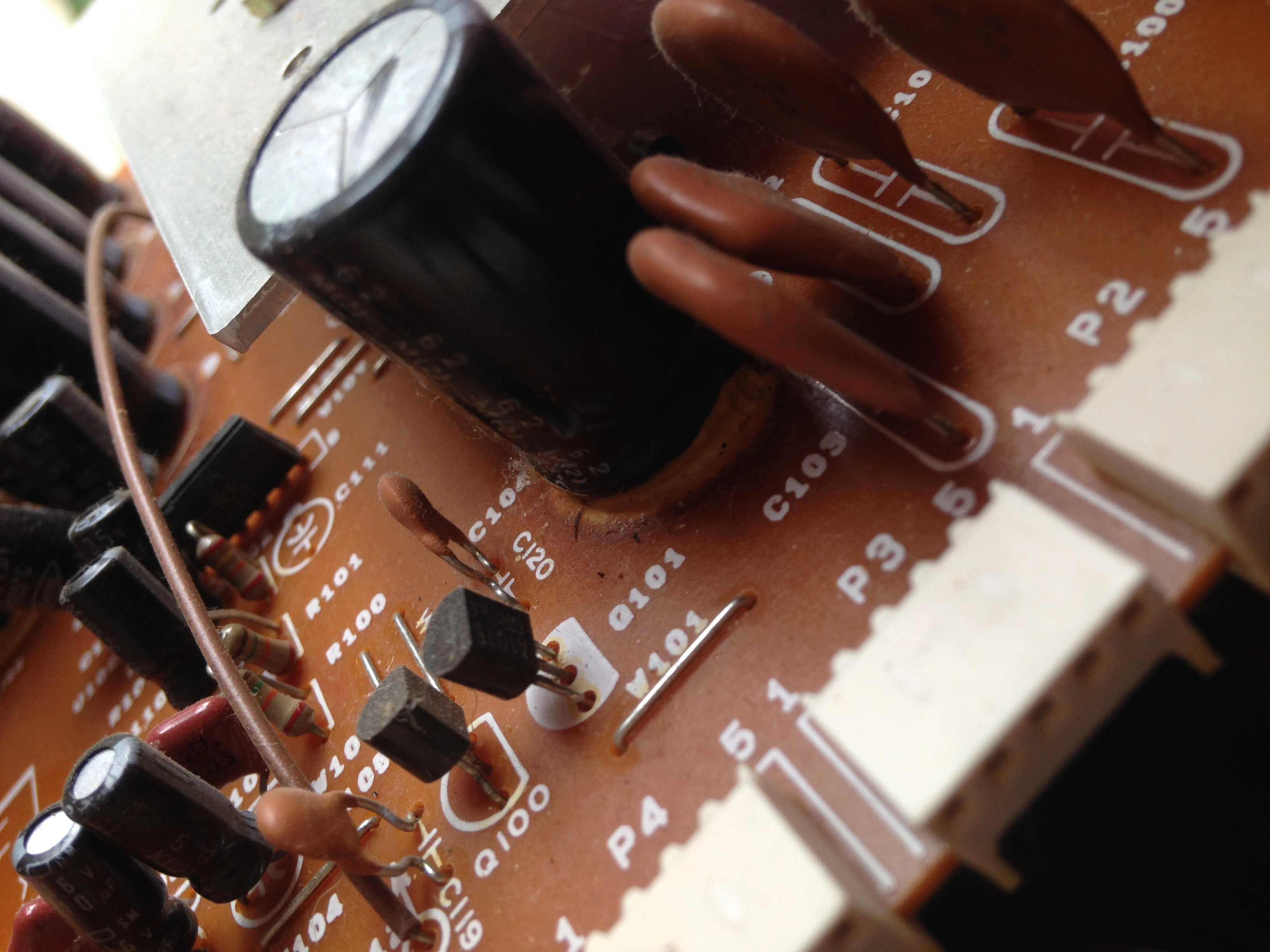

I have a question about the power supply card though. Do these caps need replacing or it is just glue or something? Here are some pics. The 388 does power up no problem so not too sure about this. Thanks!
That's just an adhesive. If you power up fine, then they are ok. You can replace them if you want though. Not a bad idea for the power supply.

The advantage to doing it now is you already have the deck apart anyway. For what it costs in caps, it's cheap insurance to just go ahead and recap while you have everything opened up.
