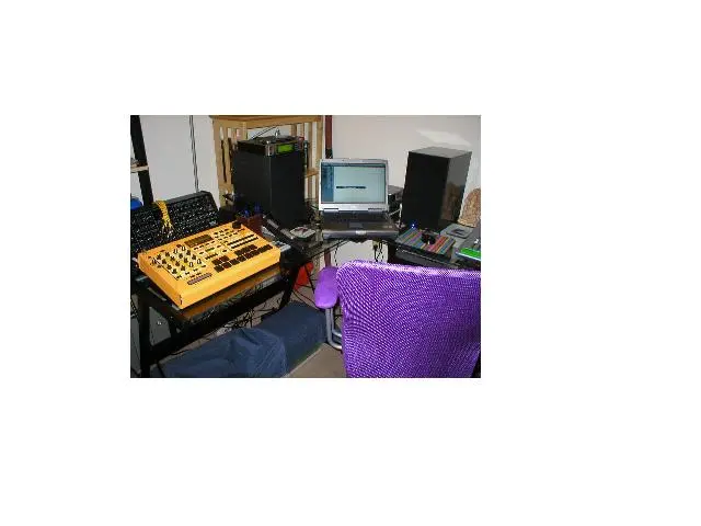

Hello All,
I feel like such a idiot for asking, as I have been in and out of recording studios for the better part of my life. However, it was always as a performer for other peoples projects. I have gotten into doing my own music and have bought myself a small studio. (Well, building it over the past 7 years is more like it.) I finally finished all the major purchases. The problem I am having is my monitors pick up all the internal movement sounds of my laptop and mouse. I have a Dell Inspiron 9100. I have the Wharfedale 8.2 Active monitors. The right monitor was making the noises, so I switched the power plug to another unit. Now, the left monitor is making the noise. I am very confused. My power cables are seperated from my audio cables. The monitors are on a different power strip than the transformer for my laptop. Any seasoned people have any ideas that can help me out? Thank you so very very much.

Try putting all the power on the same powerstrip. Are you using the laptop's sound card? If so you should ugrade to a good external card ASAP. Internal cards are much more prone to pick up noise from the computer.
I had that happening for a while too.... Never figured out why.
But it works now because I have a new motherboard.... because the old one appears to have had a capacitor litteraly explode..... it just got more and more wierd, and then finally wouldn't boot.
So maybe it was the mobo, cuz I have the same setup and pci sound card as I did before.
