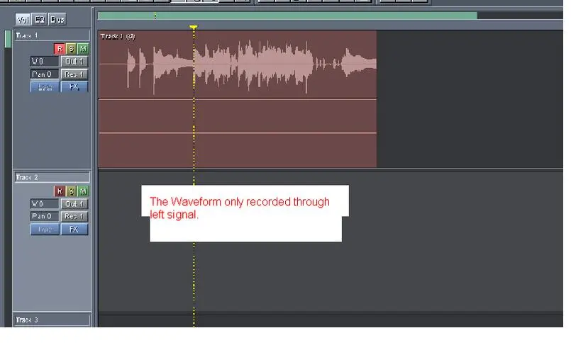

Thanks for the help. I Switched it to mono but it still looks like this. The sound only comes out through my left speakers.
If you look at your Track 1, it is showing as a stereo track, and quite rightly, it shows the signal being rcorded on the left, and nothing on the right.
It is the track itself that needs to be made a mono track.
