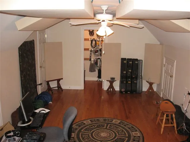

I think I would put your mix desk nearest the wall with the door, with your monitors firing down the 14 ft length. Put your monitors about 5 ft apart and 5 ft away from the listening position in an equilateral triangle. Put the listening position about 38% from the right wall for starters. Then start bass trapping the wall-wall corners and use broadband panels for the first reflection points on the side walls and ceiling over the mix area. See what that sounds like and add from there.

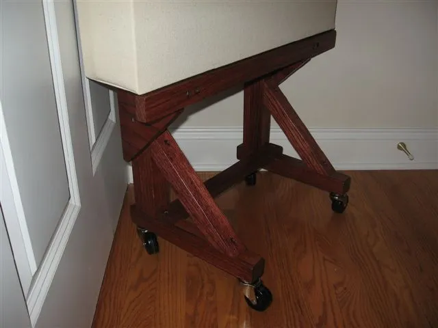

Due to location of the window at a possible first reflection point and the door at a bass trap location, you may want to put your panels on stands or casters, like in these pics.

ummm, is that door at the right side for midget engineers?:D
Great job. Exactly what I would do, except maybe a poly or two.:)....er, wait a minute. I'd rotate the mixing position 90 degrees though. Can't see the other end of the room but I would setup the monitoring geometry on the long axis....at least it looks longer on the roof ridge axis.
Hey Rick - I just realized you were referring to my bottom pic, not the OP's posted image. In the room shown in my bottom pic, the monitors do indeed fire down the long axis toward the back wall you are looking at. I just have the computer screen on the side of the room so I can put the noisy CPU in the side-wall closet there, and also to avoid reflective surfaces between the listening position and the monitors.
BTW, this was not a pic of the OP's room - it was just offered to show some possibilites (stands, casters) for "movable" bass traps near doors and windows.
Yeah, those 4 ft high closet doors are for the, um, little people that visit me from time to time.
Ooops, thats what I get for not looking at everything at the getgo. Dumb me.:o:D
