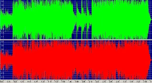

Very cool song... I like the feel and instrumentation. It's clipping a lot though. You have to bring the levels on the whole mix down some, the clipping is creating a lot of distortion and extra noise. I attached a pic of the mp3 waveform just to see if I was right, everything off the scale is clipping there and sounding distorted on my system. If you can view it like this somehow (I use goldwave... free program), try to get the peaks right below the cutoff point. Otherwise sounds like a really really good song ;)
