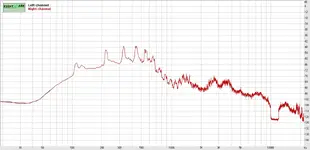

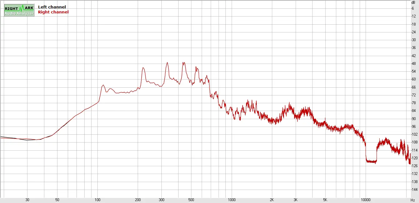

The spectrum does not show any of the usual "USB 16 bit crap" that results from a poorly setup Windows sound system and yes, could be the XLR cable, a bad joint in the screen would cause the crackle and I hear distortion on the voice (or you have had a VERY bad/good night!)
General rule for 'tronics chap? ALWAYS have spare cables. They are cheap enough these days.
