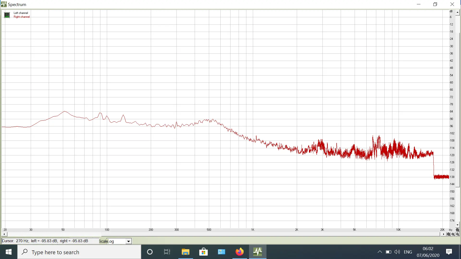

Attached is a spectrum of just the noise (clip 04) and it is only some 40dB below the average level of the speech. That is pretty poor.
I suspect the noise is being generated by the phantom power DC-DC converter but first check that there is an identical voltage on both pins 2 and 3 of the XLR (mic end) ref pin 1.
A couple of dynamic mics, spook juice off and with a similar reference voice level would pin this down for sure?
