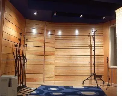

Take a look at Blue Bear's rooms. That's one of the best ways to treat a small room. A lot depends on what type of sound you want.
http://www.bluebearsound.com/
