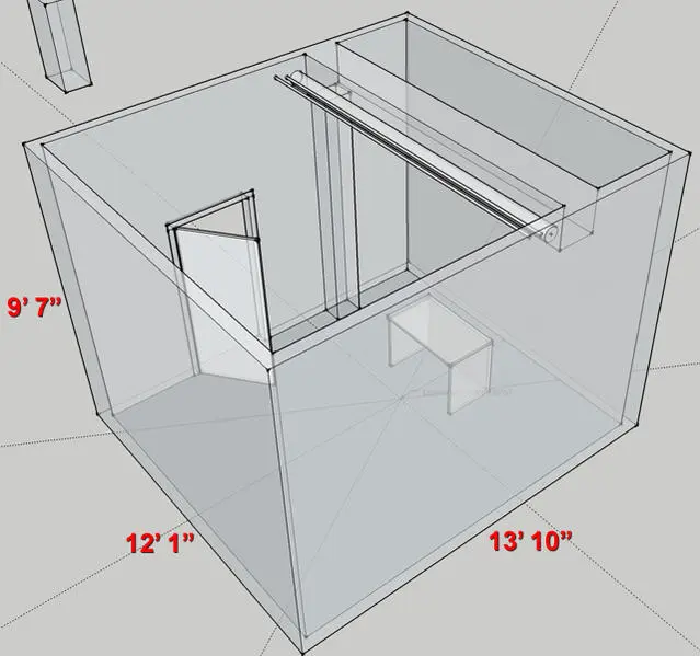

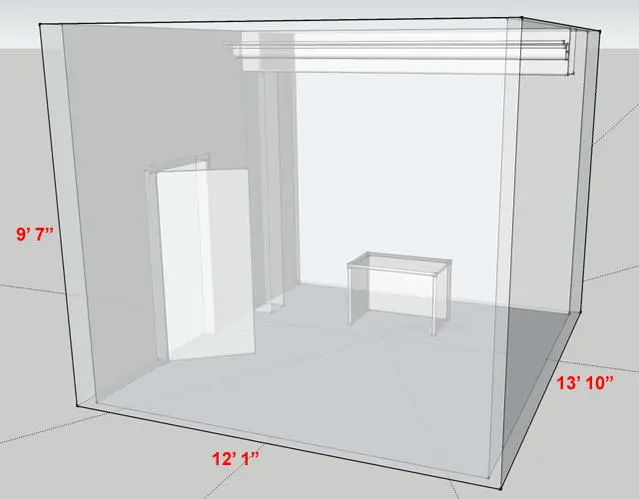

Two views of the room I did in SketchUp:
Treating properly, you should still have room for a loveseat - & two at the desk.
