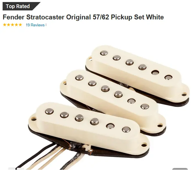

Excellent idea ashcat ! I do have a pot I can use to get that measurement. I’ve been playing it and adjusting pup height to try to get that bridge pup sound where I want it but height alone isn’t gonna do it with out affecting the combo position of middle and bridge too much.
I think some come lower, this is a pic of the same...so it seems. Poles up and pushed in "looks like"
Yup......that neck pup (top) looks just like the one I have...except that the d and g string poles on mine are even higher. The high e and b poles are way down. Makes you wonder if the neck radius was way different on the early strats and the pup heights reflected that.
