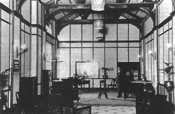

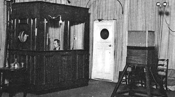

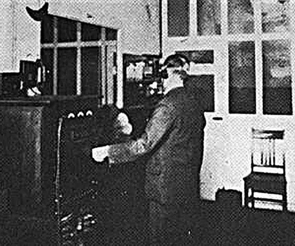

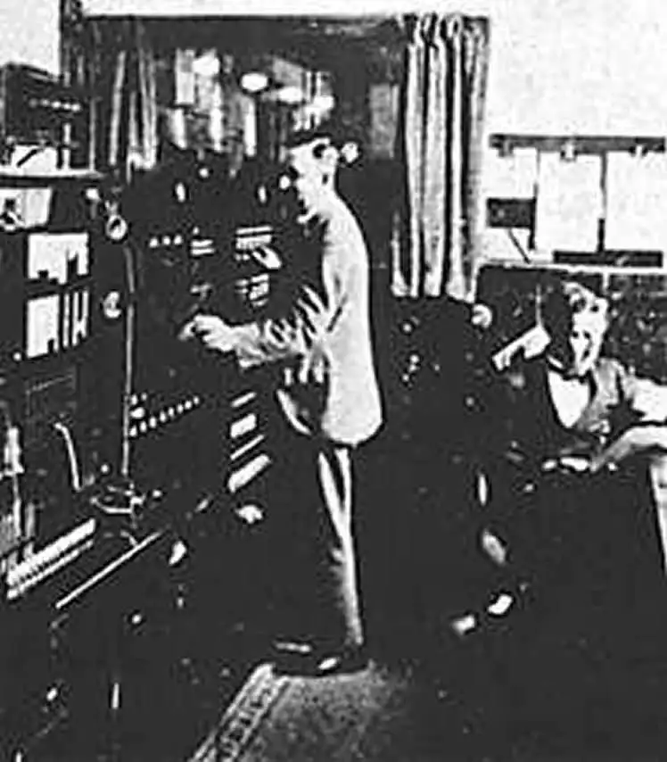

BTW, heres the latest design phylosophy;) I think I'll go back and reinvent my studio to this......:p
