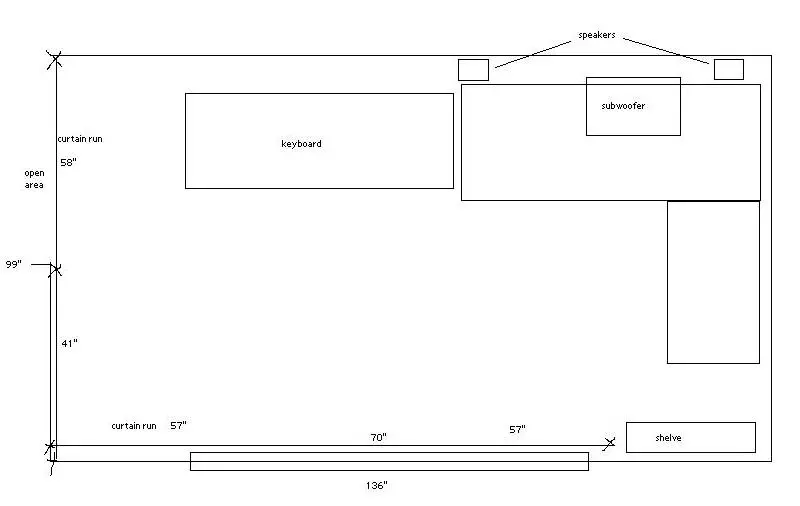

I'm new here... I am in need of your help. I have a small area... I wouldn't call it a room because one side of it is open. I live in a rent condo and would like to setup a project studio in an area that is 8.3ft X 11ft. This area has a patio door opening about 70" and it has carpet. I have attached drawing. How can I reduce noise in this area? I planned to close off the open area using thick curtains. I want to extend the curtains around to the patio door. I have a KRK Rokit 5 setup with the 10s subwoofer. My main issue is reducing bass bounce off the walls... unfortunately I have neighbors with attitudes, and second is being able to use the area for mixing and vocal recording. Any help would be greatly appreciated.

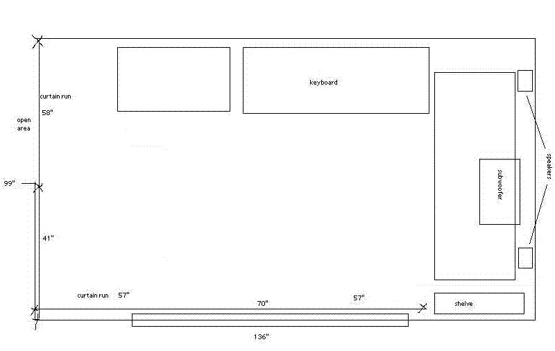

you'd be better off like this

shouldn't the speakers be away from the wall, like a foot or two?

Thanks!!! I'm wondering thou since the other end of the room in your layout will be a problem since it is open... i'm going to curtain it off, but it's not a solid structure.
Yeah probs, sorry I was in a rush. Was at my girlfriends flat and we we're just going out, so had to do it very qucikly.

Shouldn't be a problem if you curtain it off. You want the speakers to be firing down the length of the room, the longer the better. The curtain may actually help slightly absorbing mid-high frequencies.
