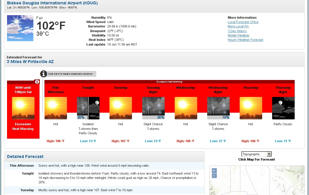

25C ? Geez we've been trying to bump 40C for over a week. With the high temps and UV index, flys seem less likely to buzz ones MIC.
