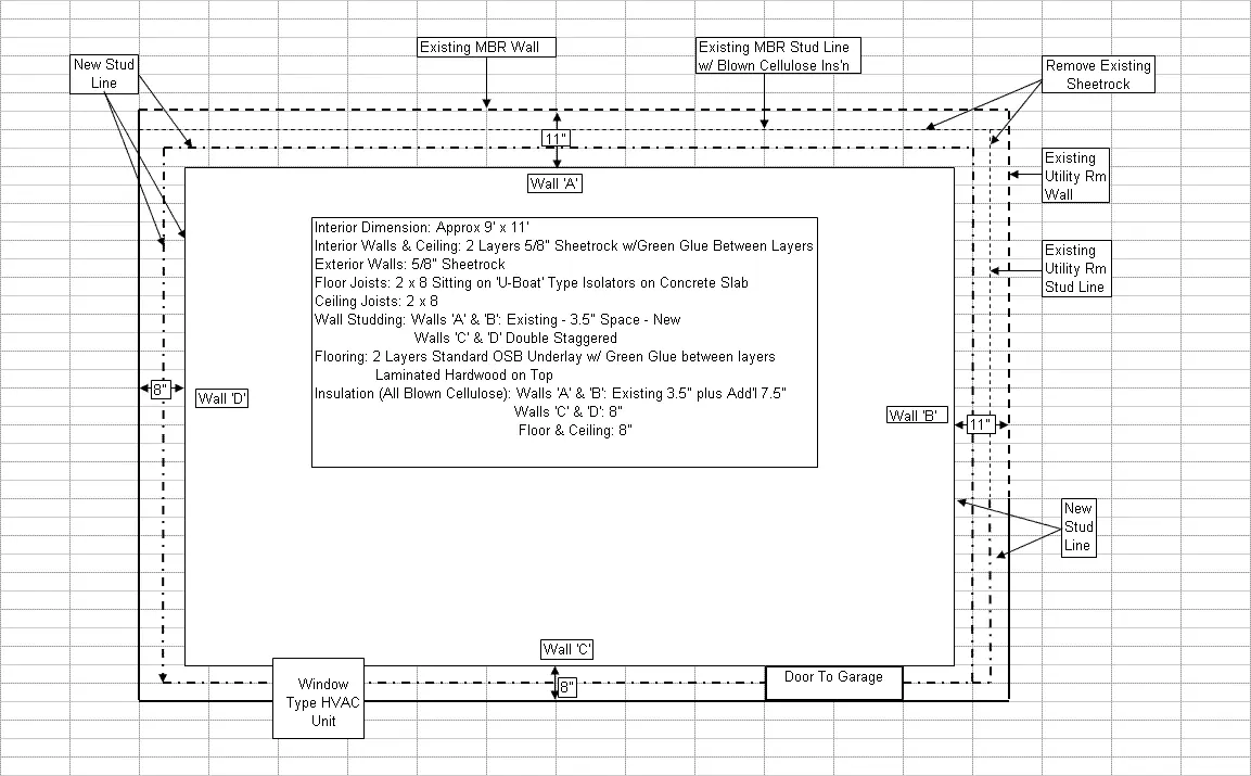

I'm now ready to begin construction. This will be essentially a free floating room inside the garage but will butt up against 1 & 1/2 existing walls of the house. Isolation from the rest of the house is a much bigger concern than room acoustics. Due to wife's elderly parents living with us, I no longer have any empty house time. Just want a place I can go and play my electrics at reasonable volume without disturbing the rest of the house. I attached a dwg & right now I'm figuring mat'ls at about $2K. Want to make sure I'm not overdoing or skimping. A few specific questions: 1. On the interior double sheetrock - do I need to Greenglue the first layer to the studs or just put it between the 2 layers. 2. Same question for floor underlayment. 3. On the new exterior walls, do I need to Greenglue between the sheetrock and the studs. 4. Right now I'm planning to build the door myself - same thickness as wall w/ tapered jamb like on a soundproof booth - good approach? 5. I know I'm going to need to figure out some baffling around the HVAC unit - suggestions on this would be welcome.

No need to do GG between the first layer and the studs nor the first floor and the joists.
On the OUTER wall, you do not want drywall on the side that's going to face the back side of the inner wall. Take it down to the studs and fill the whole cavity with insulation. If you have drywall on the inside of the outer wall, you're creating a triple leaf that can actually make transmission worse. Plus, the wider cavity will drop the resonant frequency of the gap (a good thing).
Double drywall the inner room and use Green Glue between the layers. If you had planned on the expense of extra drywall and green glue for the outer wall, the money would be better spent to add a 3rd layer of drywall to the inside of the room. Same money spent - much better performance at the cost of 1" of interior space.

Yes, I had planned to take the sheet rock off the existing exterior house walls. There will be no sheet rock between the existing interior house wall and the new interior wall of the music room - just a wide cavity filled with insulation.
Right now, I had planned on only 1 layer of sheet rock on the exterior walls, but thanks for the tip about putting another layer on the inside - something I can do later if I don't get the isolation I want.
