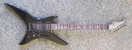

I'm not picky at all :) This is what the guitar looks like anyway:
It's not easy on everyones eyes anyway :D
As long as the neck is back in good shape, and there's no intonation problems
along with it, I'm more than happy :)
