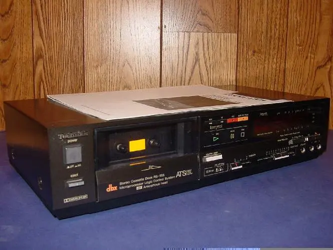

My favorite cassette deck is the Technics RS-955, DolbyB/C & dbx NR, with Fe, Cr02 or Metal tape auto select.
It's sweet and sounds great! Topline stuff!:eek:;)

Yeah, dbx, then check out 80's Technics cassette decks.
The RS-955 is actually kind of hard to find. It was topline when new and I don't know how well sold they were,... but I have three!:eek::eek::eek:;)
