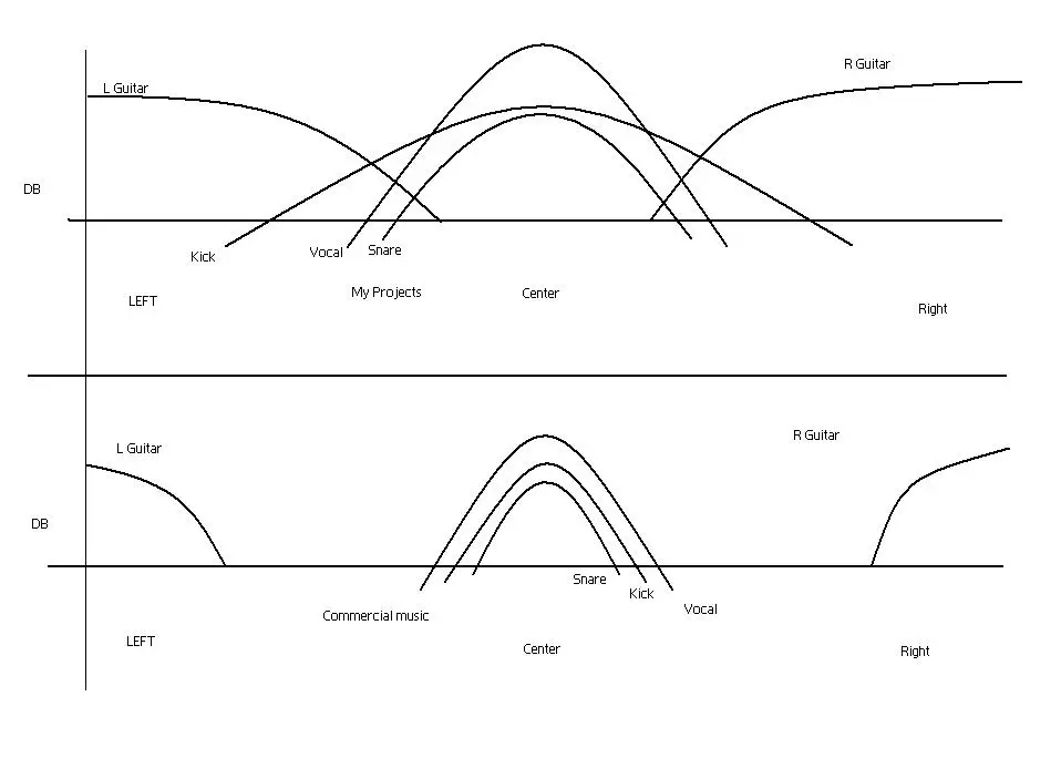

i notice in a commercial music, especially kick, snare and lead vocal. they are actually dead center and squeezed so that you can hear them right in the very middle. I have tracks for those three , the settings are dead center but they sound to wide. The problem is when you add more tracks, they fight with the center instruments coz there too wide even though its dead center, please see my picture uploaded. Im working with drum samples, not real drums.
same as with panning hard left and hard right. Again in commercial music, you can hear them all they way R or L like its going to go out of your ears or headphone. In my track, hard panning 100%, it seems that you only hear them 80% panned. I think its becuase the instrument is wide and fat.

so you are agree-ing with my picture that my projects is really wrong? just making sure.
Ill probably have to re setup all my equipment to a well known studio setup.
I would agree that a mono guitar recorded direct and dry or a kick close miked and recorded dry should not normally sound like they are covering a few dozen degrees of pan space each, that does not sound right to me.

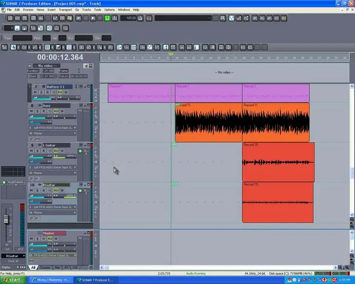

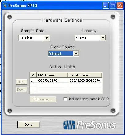

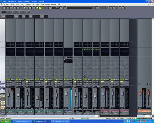

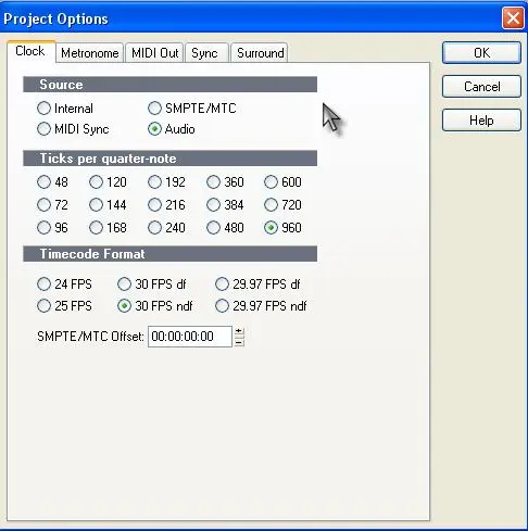

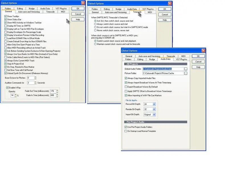

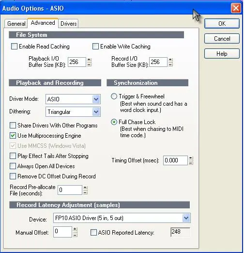

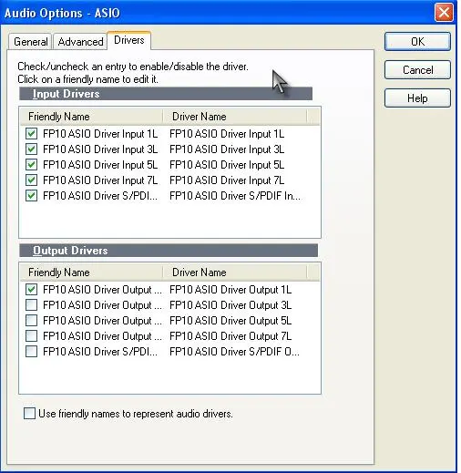

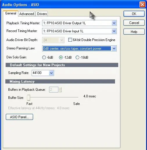

Ok here are the screenshots I can think of that you need to see. Over all, its all 20% different from the factory setting.

I think you just need to practice more, record more, learn more. then one day, you will be able to really get your tracks centered.

For some reason your screenshots are not fully displaying for me. But that's OK, here's the information you need re panning laws, including the way to get to them in Sonar: http://www.harmony-central.com/articles/tips/panning_laws/
Now, I have to be honest here; I don't really see for sure how panning laws would cause an unfocusing of the pan image, but it's the only thing I can think of that would even come close to messing with that.
If changing pan laws doesn't help you out, I might suggest that you take your problem to Cakewalk's own support forum, as they have some good guys over thee that know that software better than I do.
