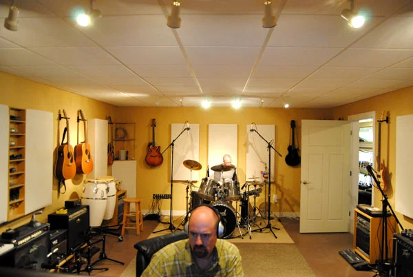

So my daughter and son-in-law/drummer came over for BBQ. I knew he'd be stoked to check out the studio, so I was ready for him. He adjusted a drum here, a cymbal there, and started playing. I was ready with all the preamps on and set, and a Cubase file open and waiting--so I hit record.
I posted a sample of the drums (just drums for now) in the clinic. I'd love to know what you think. To avoid completely cross-posting, here's a link to that:
https://homerecording.com/bbs/showthread.php?p=3483452#post3483452
And here's a pic of us in the studio. I'm the old bald guy in the foreground (duh!) and he's the young bald guy in the background (duh!).

Little bit late to the game, but man alive... I'm speechless. Must be a dream come true. Amazing. Thanks for sharing the experience.
WhiteStrat...that's pitiful, man. If you can't do any better than that, then you need to give up and patch wheel barrow tires for a living.
:laughings::laughings::laughings:
Ok...I'm obviously joking. I'm so jealous. It looks absolutely stunning. The only thing that I would add is a bed because I would never leave. Great job.

What are those white panels on your wall? Like the panels in front of your desk. Storage? Or are they panels to kill reflections and what not.
Those are acoustic panels--for treating the space by absorbtion to (yep, you guessed it) kill reflections and what not. Look up "703" in the search box and you'll find more than you ever wanted to know about 'em! :)

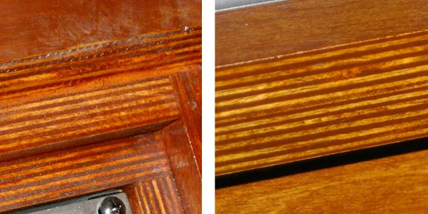

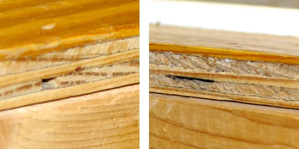

What kind of wood is that that you used? I believe that I read way earlier that its cabinet quality. Does that mean its flatter?

I used cabinet grade birch. Standard grade plywood has 5 to 7 layers (or ply's) and cabinet grade usually has 11 or 13. Standard grade also has more filler on the flat surfaces and more holes on the edges of the ply's, where cabinet grade is far more "finished."
I don't know if it's "flatter" or not. I suppose more layers could make it more dimensionally stable, but for me it was about the appearance. The flat surfaces were "prettier"--more like furniture. And since I wanted to finish the plywood edges instead of capping them all, I wanted the nice clean, tiny stripes that the 13 ply cabinet grade wood gave me.

Here's what I'm talking about. The first image is a couple shots of standard grade plywood--it's the top of my workbench in the shop. The second image is a couple shots of edges of my desk in the studio--cabinet grade plywood. Of course, with the desk, it's multiple layers of plywood forming the joints, whereas there's just one layer on the workbench, but you can see the difference. 5 rough layers on the workbench, and 11 smoother layers on the studio desk. (That second shot of the studio desk is two pieces of plywood right on top of each other, so it looks like 22 layers.)

Hey whitestrat! While "cabinet grade" is good for casegoods, if you REALLY need something really flat, and will NEVER warp..try Armorcore. Great stuff. Instead of all wood plys, the two outer plys are actually masonite, with voidless inner plys of birch, and the finish veneers are applied to the masonite. I just built an entire contemporary kitchen w/ Riff cut Oak Armorcore for the doors and case ends. Works great. Now I'm getting ready to build my own kitchen out of Armorcore w/ BRAZILIAN MAHOGONY veneers. Absolutely stunning wood. Expensive though.
