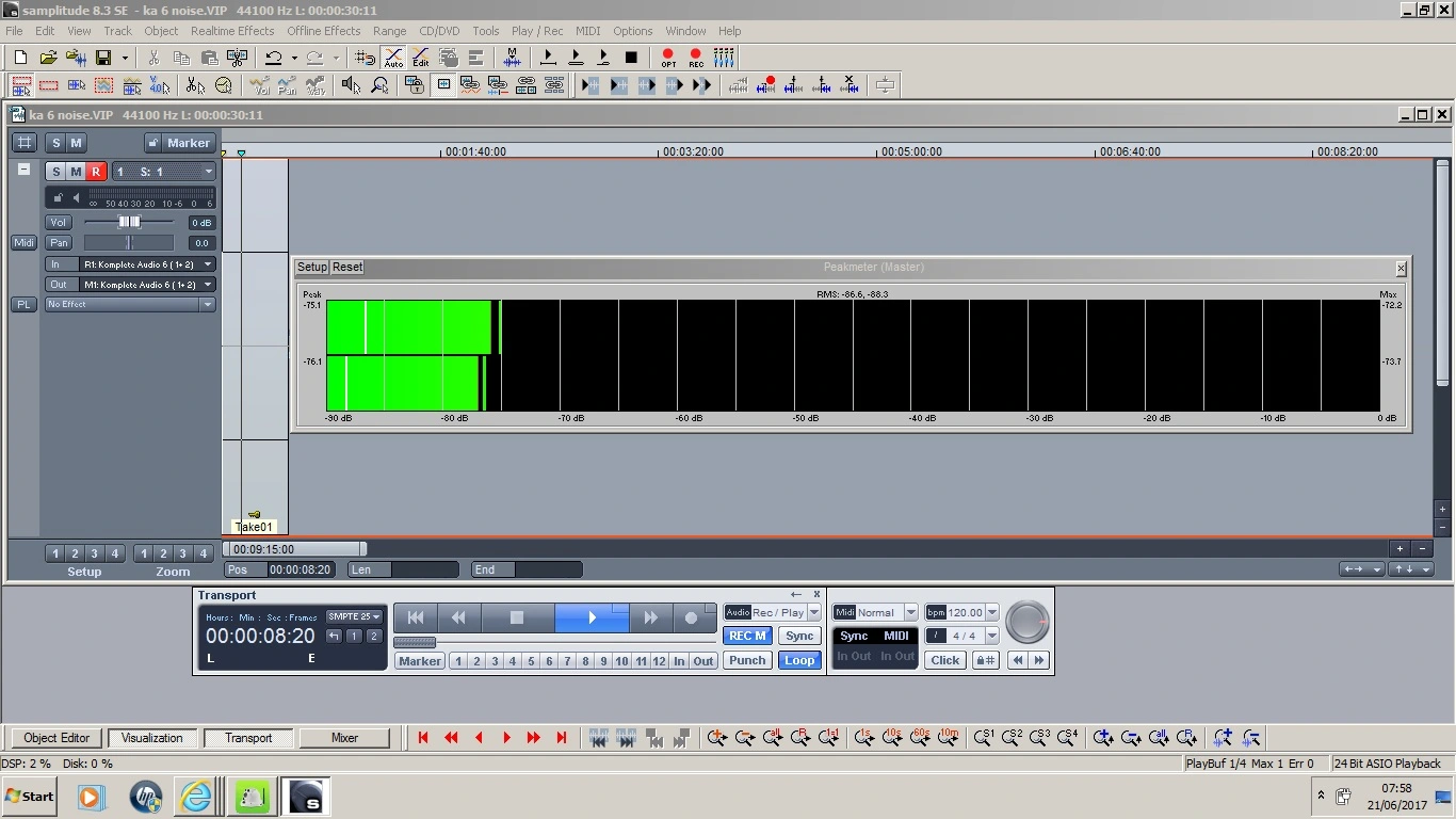

Shown are the mic pre noises (L&R) for the KA6 at max gain, open circuit XLR (worse case) and a 320M HQ MP3 of the sound.
With a 57 you need to be within 50mm of the grill to get -20dBFS on speech, any kind of singing would NOT need full gain and the (already bloody good!) noise figures would be better.
Has to be said though, 'horses for courses'. If speech is your prime interest a capacitor (aka and archaic name 'condenser') is favourite but you need a very quiet space and even then you will do a lot of editing and re-takes.

"Sorry, I do not fully understand your post, " I have posted an MP3 clip of the 'noise floor' of my Native Instruments KA6 interface. That is how it should be done! All other cobbled together mic recording systems into a computer are pretty much doomed to poor results, especially with a low output dynamic.
You need to grasp some basic, electronic/audio concepts: Mics turn sound pressure (usually) waves into very wee electrical signals. The Shure dynamics typically produce about 2millivolts (2/1000!) for a sound level of 90dB SPL (Google some of this!). Speech is typically 70-75dB SPL* and so the voltage will be closer to 0.7mV or 700 MICRO volts!
Now, ALL electronic circuits, amplifiers, produce noise (G again! 'White noise') HOW much noise depends upon the quality of the pre amplifier's build. The KA6 has very good pre amps. Pay $1000 for a Grace M101 and you will do a bit better (in fact the noise won't be THAT much lower but you would get more gain** for same noise level)
