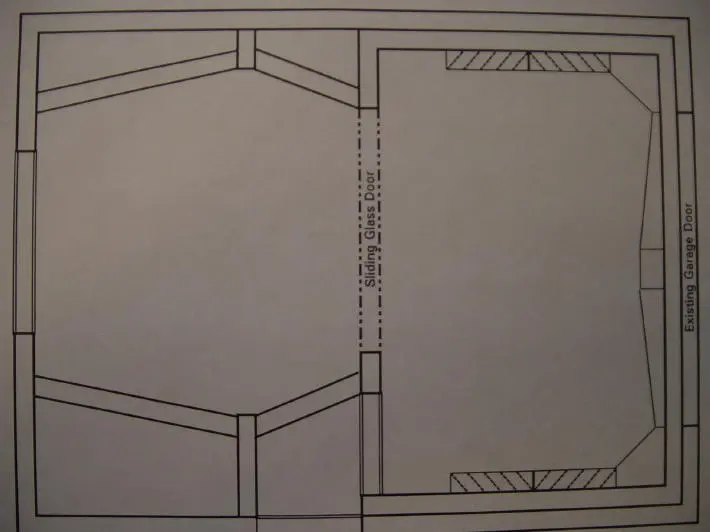

Well, Here's a plan that might work for my space. I had to take a picture of the actual paper that it's on because I did it on Microsoft Excel on computer at work. I don't have excel at home. Sorry for the crued pic. Any thoughts?
RF

Yeah that's pretty cool. The only thing I notice right of the bat is the highly reflective surface of the sliding glass door right behind the mix position.
Some heavy curtians that you could draw closed while mixing might be the ticket there though.
It would be nice if the speakers could fire in the long dimension of the room, but that would kind of ruin your view...
What about one of those flat bamboo shades that roll up. That would be kind of cool. Wouldn't that act essentialy as a slot resonator? During mixing, I might be able to use a bamboo shade for half of the glass, and just open the other side to let the frequncies escape into the live room!?

You may get some diffusion from a bamboo shade, but I thing it would be negligible.
In order for a slot resonator to function correctly it must be sealed - top, bottom and sides.
