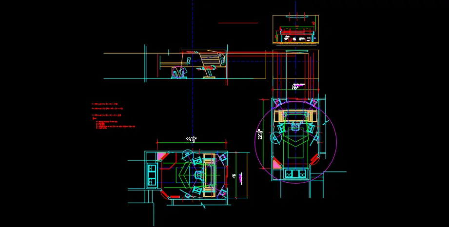

could you guys draw something up in autocad? if you would that would be a great help!as for the sarcasumus/obnoximus stuff that is cool and i enjoy reading it its funny but......
Yes.
This is my friendlisus/helpfulsus side. :)
This is to show you what can be illustrated via Autocad, and how I use it for my studio design/detailing/wireing etc.
Here are some examples of my studio Autocad files.

These are a few TYPICAL wall sections.
http://www.psychossite.com/rkpics/EXWLstdy.jpg
http://www.psychossite.com/rkpics/EXINWLstdy.jpg
These are some Autocad studio Elevtion/Plan design studies etc.
My Autocad computer is down for a few days. I'll be back as soon as I can with your plan and other stuff.
These are quadradic residue diffuser design studies and some junk.

fitZ

G'day guitar junkie. Well, I only have a little time to give you a few pointers.
Lets rationalize some things. First, there are three areas of studio design to consider. Isolation goals, treatment goals, recording goals.
Lets talk about the isolation goal. Unless you are Bill Gates, "soundproofing" is a "in the ear of the beholder" kind of thing. The real term is SOUND TRANSMISSION LOSS. This translates into what it takes in materials and construction techniques, to keep sound from entering and exiting the recording and monitoring space. There are two ways that this happens. Airborn transmission, and structural transmission. Both in and out. To determine what it is going to take to achieve this, one must evaluate three things(basically).
1) The external and internal noise db profile or noise floor. This means finding out what type, and how loud environmental noise is outside of the barn. This means cars, cows, trains, aircraft, guns, dogs, tractors, ........you know, things that produce noise. And how LOUD is this noise, both outside, and inside of the building. Most professional studio designers, must know this to evaluate this from the beginning of the project, in order to select the correct solution to fit the need. This is usually done by measuring the ambient noise floor. Why would anyone build an isolation assembly to keep out 140db :eek: (which a jet plane will produce at 50 ft) if you only need an to keep out or in, 50db? Comprende? This is why isolation assemblys are tested. Then they are given what is known as an STC rating.
STC stands for SOUND TRANSMISSION CLASS. This is a rating given to an assembly such as a wall, by a testing authority, after performing sound transmission tests in a special building. These ratings are used
by designers to determine what isolation assemblies they must use to successfully achieve their isolation goals. Understand? Otherwise, they would be guessing, and guessing can cost BIG $ and time, both of which no one has to waste.
Here is the next reason. Because every increase of ONE DB in sound pressure, requires 10 times the ability of an assembly to produce TRANSMISSION LOSS! :eek: Just for the increase of ONE DB.
Not easy.
2) The next thing is the type and db profile of sound PRODUCED in the studio.
Why build isolation for a rock band with stacks of marshalls playing at full volume at 2:00 in the morning, with neighbors 10 feet away, if you are only recording acoustic guitar and vocals in a barn 100 feet from the nearest source of displeasure(neighbors who hate music :D ) Does that make sense?
3)If you cannot meet the ABSOLUTE requirements of your isolation goals, then you must determine to WHAT EXTENT, and WHEN you must alter your expectations. This is what I meant about "in the ear of the beholder".
If you have the budget to fully meet your expectations, more the better. However, few homerecording enthusiasts have the luxury of achieving this goal. It would be nice if everyone could afford to truly have a TOTALLY isolated studio. But that is not the case. Most everyone has to make compromises at some point, by various means. This could be recording at certain times of the day, to building a smaller isolation BOOTH, and many many other compromises. Most studios that meet stringint isolation requirements, cost MEGA BUCKS to do so.
