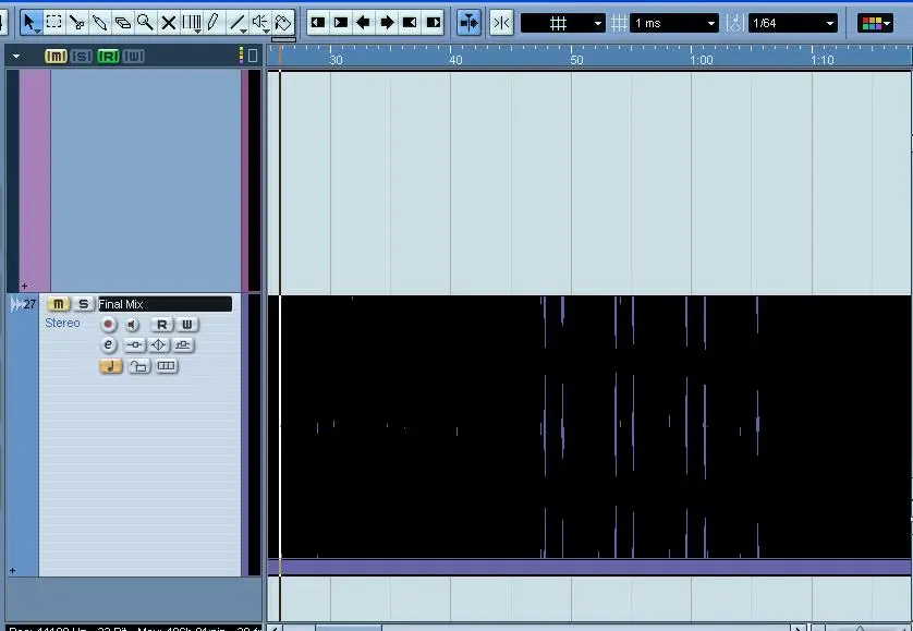

after i masterted it, it got loud but scratchy. How can i make better from the "scratzchyness'? Please help :( . It looks weird when I put it back into my Cubase DAW's. It looks WAYYYYYYY more even which I like, but I don't like the scratchy quality's I can hear from it. You can't see any scratching on the waveform picture, while before it looked pretty bad or awful. Weird. Help me, thanks.

but when i turned it up everything got smoothed out like how I wanted it to be on the waveform. I don't get it?
If everything is "smooth" in the graphical waveform, then you have it clipped straight across! :eek:
The wav should look like a fuzzy caterpillar...a bit fatter than the unmastered (un-limited) caterpillar...lol
If you are seeing flat edges (overs) you are clipping.
A quiet mix is much better than a digitally clipped mix... ;)
It *looks* "way more even..."

here's the waveform. How much is a passive summing thing?

You don't need passive summing you need to not use some much leveling or compression. You're squashing the crap out of your mix which is creating distortion which sounds terrible. Just back off the levelor, you'll lose some volume but you'll still have a quality track.

When working with audio it's usually a better idea to go by how it sounds, rather than what it looks like.
With that said, it looks like shit.
It looks like you went crazy with the limiter. If you hear distortion, or "cats going wild" (same thing I guess), then you probably used too much.

the display is messed up, i think i accidentally had some meter turned up a little that makes the wave taller. It's still very smoothe but you can see a little more white stuff, if that helps you with my answer? Also, how am i supposed to get it louder without turning the volume knob up? I don't get it.

Dither noise is below -80dbfs. Digital distortion is the most likely culpret.
