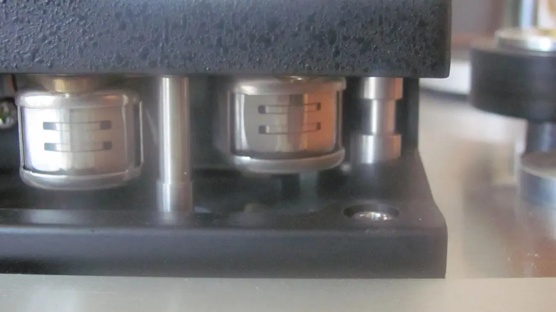

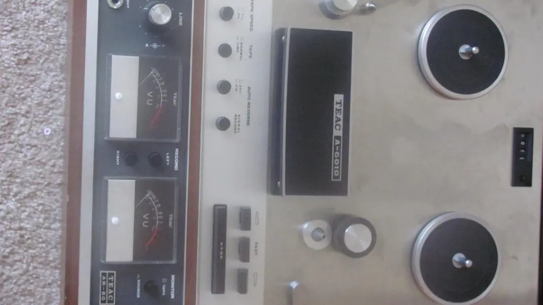

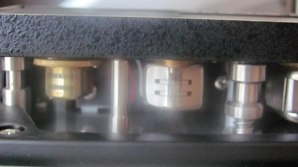

Ok, so a while ago I asked you all about the Teac A-6010. Well I finally have some pictures for you. And along with those pics I have some questions.
With no tape on it, the transport seems to work fine. If I tell it to fast forward the take up reel's post spins quickly. In fast rewind, same thing for the "feeder reel" (IDK whatelse to call it.) Anyway. Everything works. Well. I put tape on it, and no dice. I've tried both mil settings to see if that worked. Nothing. So I'm guessing it's the tape. I don't even know what tape it is, the dude gave it to me. Anyway, what do you all think I should do? Well, here are the pics.

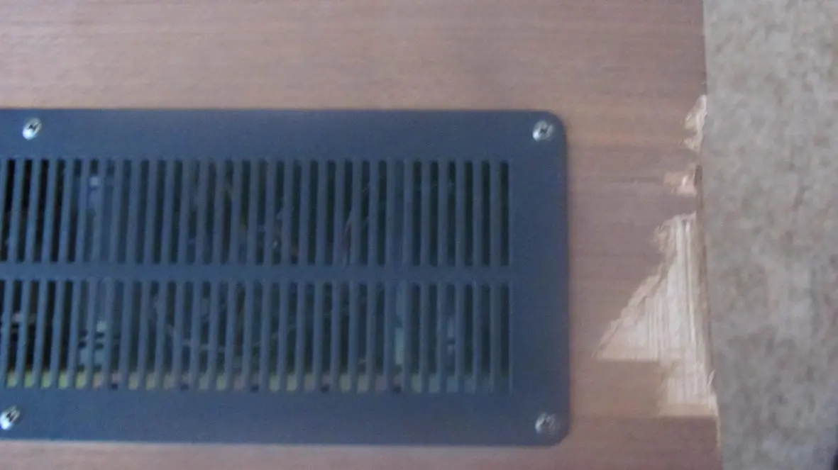

It seems to be in pretty good condition, but it's not withouth its dings. (PS I know it's not perfect as a mixdown deck. But for $25 I figured it would be worth the experiment. Plus I figure I could part it out if I needed to and probably make a small profit.)

It will rewind just fine. But any forward motion is stopped because the take up reel does not take up releasing the tension on the tension arm. Thanks for the responses. How do the heads look? I'm still learning. so be patient with me.
