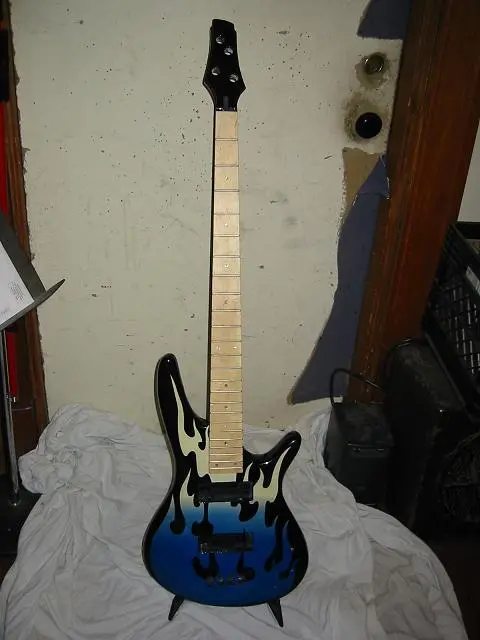

So the $38 Blue Flame bass kit from guitarfetish.com arrived today. It's definitely gonna be an oddball once I get it together. Already I can see some challenges I didn't foresee. But I'm sure I'll learn something in the process.
Here are some pics to start with....
The "art shot"....

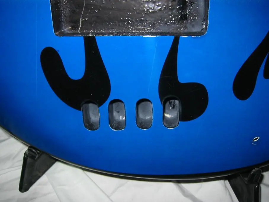

Here's the first thing that makes me go hmmmmmmm...
This is NOT a string-through-body design after all. So what are these wells for?

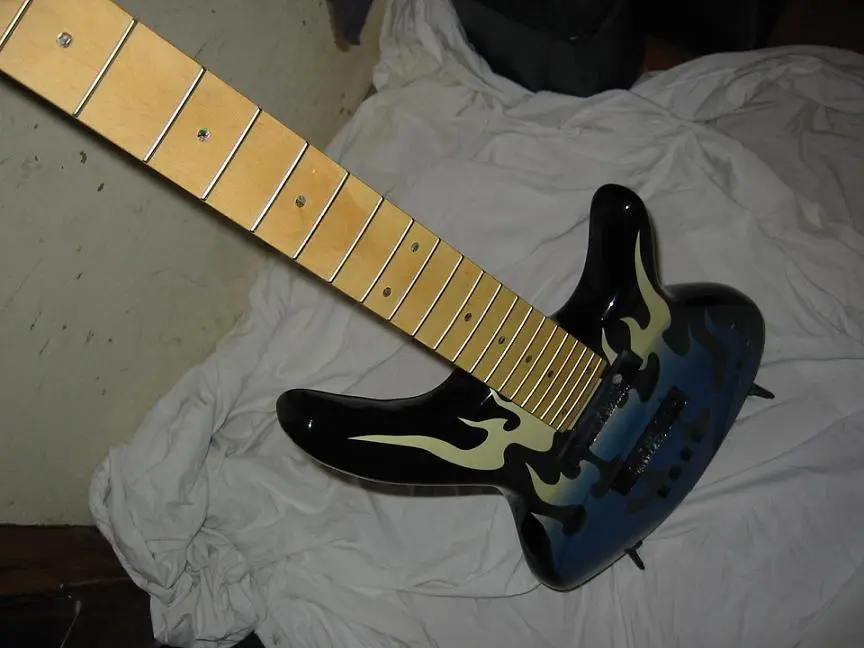

....maple fretboard?
Fretboard and neck are the same piece of maple, and unfinished at that. The fret markers are nice and flush though, and most of the fingerboard area is smooth. There are two or three spots that could use some fine sanding.
They look like they could be routed areas for individual saddles. I'll try to find a picture.

Okay, Mad Audio, I think this might be what you're looking for:
Oooooh, individual bridges! That's actually pretty cool, and would certainly fit in with the paint job on this beast! Thanks, man - well deserved greenies for you! :D :cool:

Nope I believe your right on the money mate. I don't do basses as you know but that looks about right.
The first thing you need to do is establish exactly where your string length ends on the body. That will dictate the type of bridge/saddle arrangement you can get on it. A very soft pencil or better still a chalk line will help. Measure from the nut back to the body. Then you can set your bridge to allow for some forward and backward adjustment when its in place. String length is the FIRST consideration on any stringed instrument. Everything else is designed around it.
Nice looking project by the way good luck with it and keep posting pics..
Thanks for the reply. Sorry I didn't acknowledge it sooner, but it will help me get started. I imagine this will not be a quick build, but I will keep this thread updated.
BTW, it seems the common term is 'single string bass bridge." At least that's what yielded the best Google hits! :D
