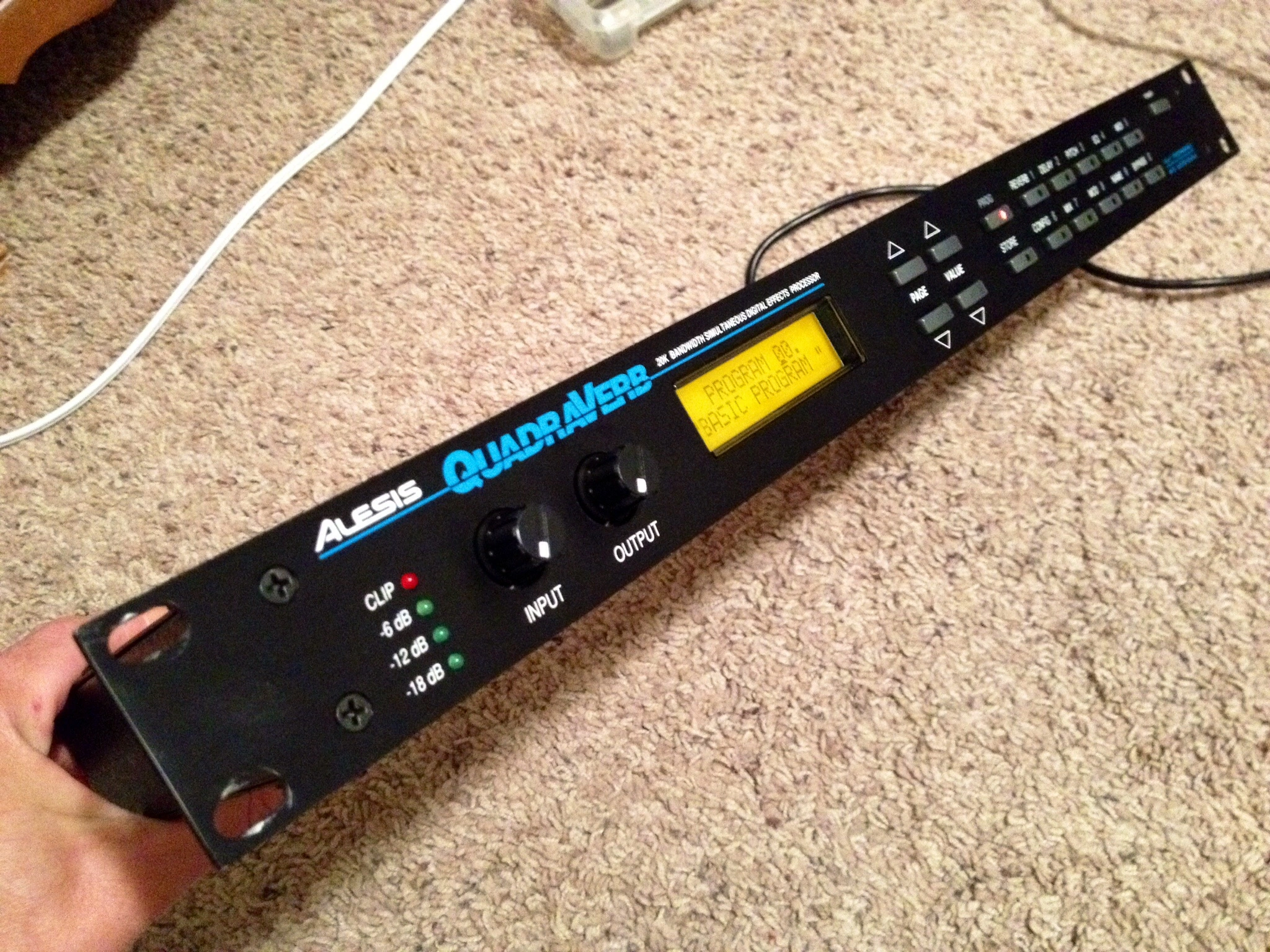

Picked it up today. He made no promises...in fact made it clear he thought it wouldn't work. Says it was part of Guns 'n' Roses live rig at some point. Anyway its actually in nice shape cosmetically...missing the level knobs but I have those from my parts unit.
Plugged it in annnnnnnnd...
Nothing.
Opened it up. Sniff-sniff-sniff...
Mmmmmmm burned electrical.
Found the stinker...cooked ceramic blocking cap across the power switch. Everything else looked really nice.
Pulled the cooked part, put in an equivalent part and viola! Works like a charm. Free Quadraverb and it even has the "Plus" chip installed. Gonna clean it up and recap it, service the pots and put it in the rack.
