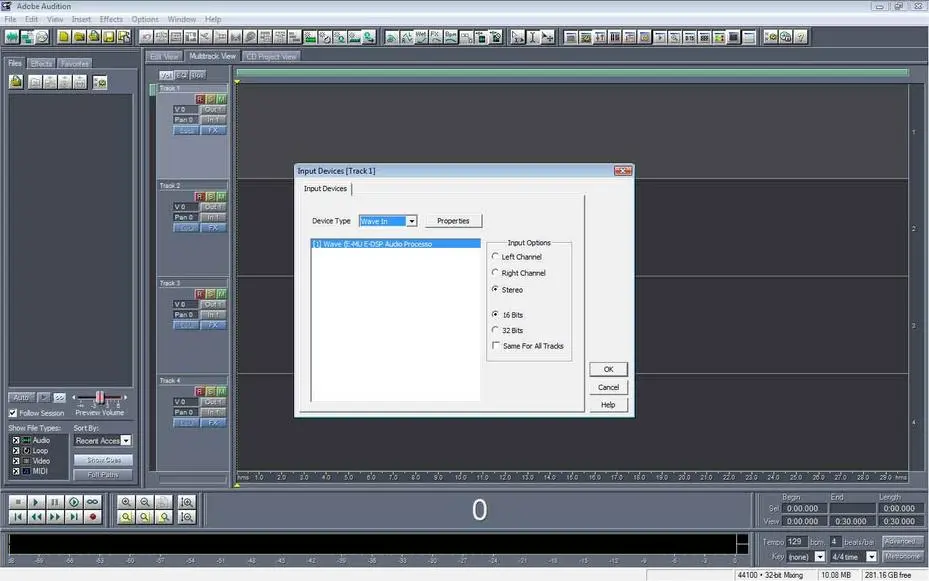

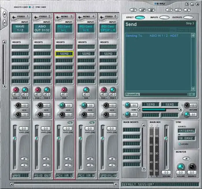

Your suggestion makes total sense, but when I click on that "In" button, I don't get those options. I've attached two screenshots; the first is my Patchmix window (the "send" info on the right side shows the L input sending to ASIO 1/2 - the R sends to 3/4 and the S/PDIF sends to 5/6). The second is my Audition window showing the options I get when I hit that "In" button.
Any thoughts? Looks basically like Audition isn't recognising the multiple input options. Sorry the images are low quality, trying to keep filesizes down.

Well for starters I don't believe AA1.5 supported ASIO
But if you have multiple hardware options (devices, drivers, etc.) Those need to be setup no matter which software you use for audio work. And different applications can use different variations on all the options. But, as mentioned I don't think, in AA1.5, ASIO was one of those options; this leaves WDM, MME, or some hardware proprietary variation on kernel streaming.
Off the top of my head it has been long enough since I tried to set up Patch mix that I would not want to pretend I could do it off the cuff . . . It was, for me, always slightly counter intuitive . . . Powerful and useful but definitely required some opening of the support files to even get to work, for me, at all.
That said. Audition has no control over A/D functions at all. It simply accepts data passed to it via the hardware layers. So first, next suggestion is that the s/pdif input has not be activated in AA preferences menu. (don't have 1.5 on this machine and finally migrated to 3 a year ago so cant get to specific labels but if I remember they used to show up in 'options' menu under settings) Under one of the tabs you'll have a divided screen, hardware I/O options AA can recognize (compatible hardware layers/drivers) on the left and ones 'activated' for use on the right. For an available, not activated option, you simple highlight an option in left hand panel, click the action that shifts it into the right had panel. These options should now be available in multitrack options.
AA (1.5) can recognize and use Emu PCI 0404 s/pdif so it not showing up in multitrack is not an inherent problem with AA.
What I can't remember is whether the PCI 0404 supports simultaneous analog digital input (you can route the same signal to analog, and both RCA and optical outputs but that is a very different issue then integrating input from multiple sources.
If 0404 digital is activated in AA then for whatever reason you don't have simultaneous analog digital input in AA, but switching to mono you can get two independent sources . . . But not three or four
I think you hit the nail on the head with the "I don't believe AA1.5 supporting ASIO". I've done some more reading and that seems to be root of the problem. Seems that E-Mu don't produce full WDM drivers for their hardware. I'm going to get an upgrade package and update to AA3.0 - I've been looking for an excuse to update anyway, but 3.0 apparently does support ASIO. And I'll see if that solves the problem...
