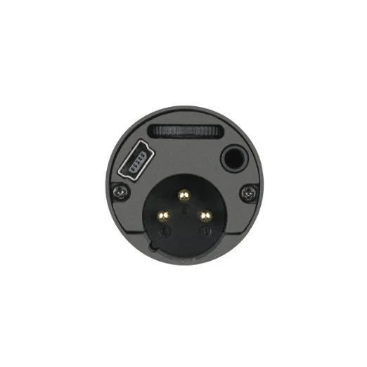

Well some USB mics can be plugged into a mixers XLR input. I've got an Audio Technica dynamic (ATR2005USB) that can do just that. There are also condensers that are dual fitted with USB and XLR as well. :D

That microphone you mentioned, is it a standard USB, or an xlr converted to a USB?
