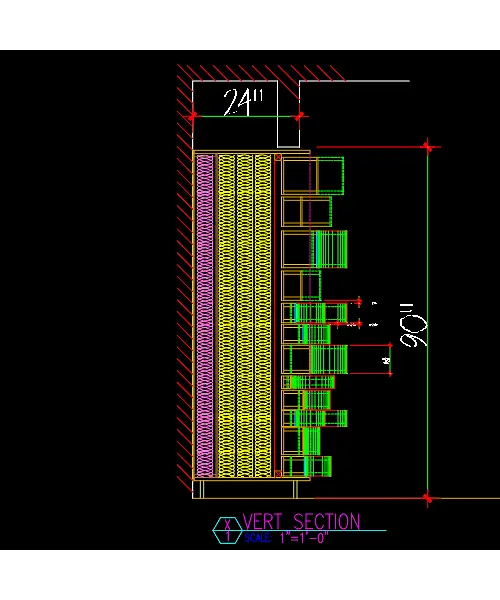

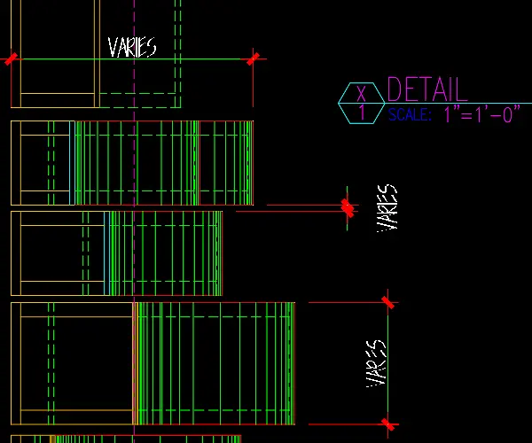

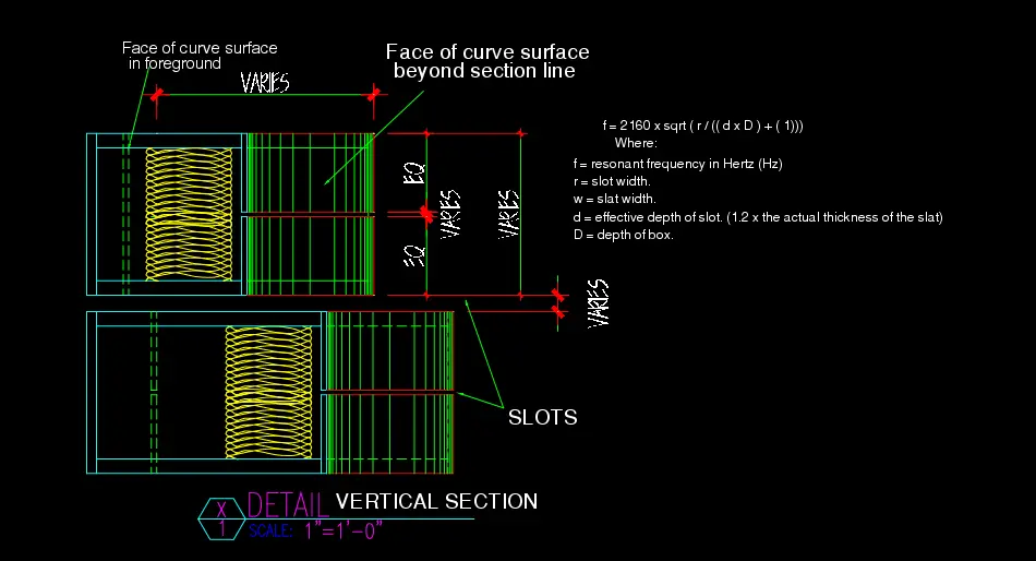

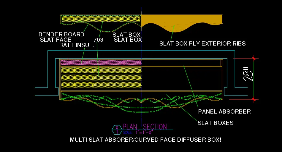

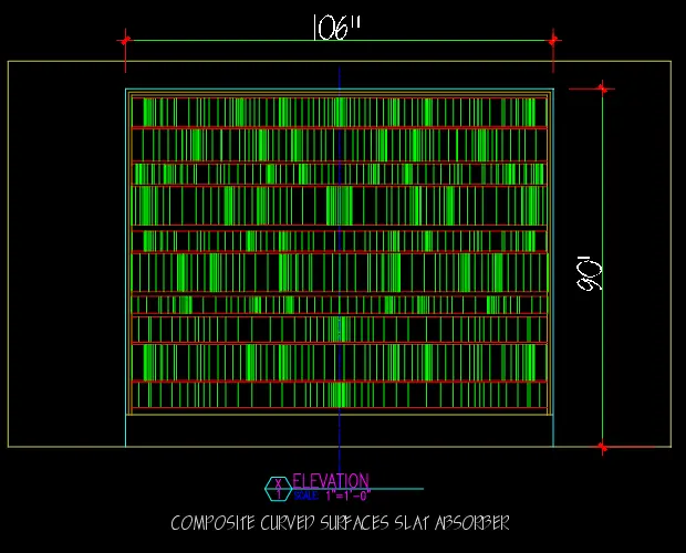

Ok, enough..here is the drawings. This series of drawings is an elevation of my back wall closet, with the unit in it. There is a plan section, a vertical section, and 2 details. Can anyone offer a yea or neh, and if a yea, any kind of information about the formula for sizing a panel absorber. And will a panel absorber work in this configuration?

Here is the elevation.

Here is the Plan Section

Here is the Vertical Section

Here is a Vert Section Detail of a Slat Box

Here is a another Detail

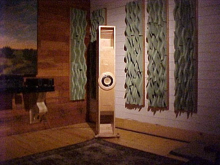

Here is where the idea originally came from..
the difference is these are flat board diffusers, mine are curved front Abfusors.

Rick,
> you said modes are not that important if you can't move walls....well what are panel absorbers for then, as they are NOT broadband? <
The combination of low-bass and high-bass wood panel bass traps shown in my plans are indeed broadband. Or relatively so, anyway. Yes, a panel trap has a center frequency at which its absorption is maximum. But the rigid fiberglass inside lowers the Q to make it absorb over a range of about an octave.
My comment about modes and moving walls was in a different context altogether. All the time people run my ModeCalc program and then ask me how to use the results. My standard answer is that a mode calculator helps mainly when designing a new room to assess the various proposed dimensions. If your room is already built, knowing the modes is moot because you can't do anything about them except treat them.
--Ethan
Cool design Rick. The only weak link may be the density of the facia material. The higher the density the better the low end diffusion and usually they use hardwood or stone for that reason. I've been checking out different trim woods at the Home Depot for a similar diffusor design.
