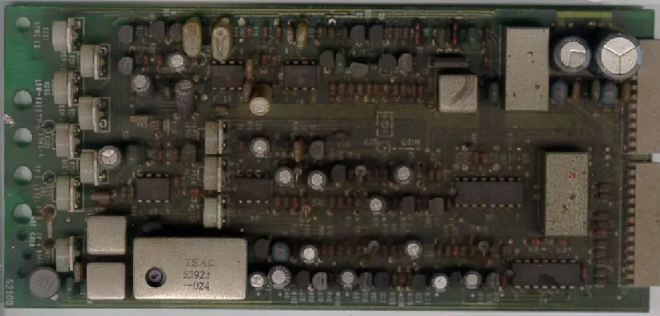

Channel cards
I got a chance to do some work this weekend on the MS-16. Actually it has been a mend and make weekend with lots of house chores. Last weekend I played hooky and got in a hike - 17.5 hours, 22 miles and 6500' altitude gain looking for a trail lost since they stopped mantaining it at the end of WW2. Found the trail here and there. But that is another epic....
Anyway the top 4 channel cards were coated in a thick layer of dust. Spent an hour or 2 with a brush and a shop vac. They look better now. THe lower 3 rows of cards were mostly dust free.
What is more of a problem is that on 7 of the 16 cards the TC4001 cmos quad nor gates were blown. Blown as in the plastic cracked or blew off. I've seen this before when the chips self destruct thermally due to shorts or over voltage. Looks like I have some testing to do in the PS rails.
You can see the blown chip with a chunk out of it in the lower right hand corner. Anybody else see this?
I have a manual on (back) order from tascam. But it is at lease a week or 2 away. Anybody got a scan of the channel cards schematic handy to get me going?

Blown IC

Ethan,
What's the p/n on that amp card PCB??
The assembly looks identical to my 58 amp PCB's! :eek:
if that's the case, I'll be happy to put up a schematic.
Better yet, can anybody with an MS-16 manual confirm the amp card PCB assembly part number? If it is the same as the 58, and if anybody has any spare cards (i.e. Pianodano ;)) and you are interested in selling any, I'd love to have a couple spares!
The 58 amp card assembly p/n is 5200083210
The amp card PC board p/n is 5210083201
Also, is there anybody with an MS-16 that has a spare "angle" on the meter panel? It is the little handle on the right and left of the meter panel face. On the 58 these are actually used to pull the panel and access the amp cards. One of mine is broken and they are discontinued.

Yes, the blown chips are a puzzle. Hopefully the cause is long gone (hah!)

Ethan, so with blown chips does that mean possible blown caps in the PS?

Also, the p/n for the pcb assembly is 5200083220 and the pcb is 5210083202.
:mad: Bummer. Might actually be the same assembly with a differing part number to differentiate the deck model...
Ethan, would you be willing to cross-reference the 58 card with a schematic I would scan and upload with the hard-copy you get from Talldog?
The cards look so similar...

Same card
Those are the same cards! Sure I'll do it.
