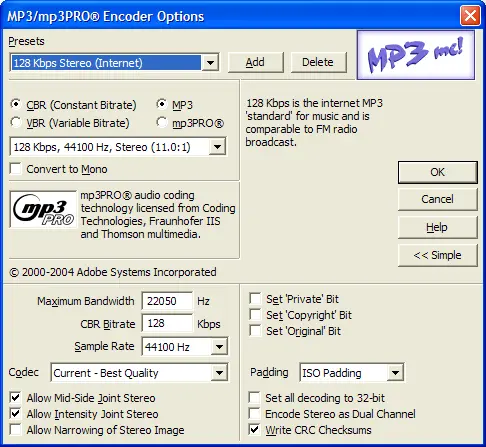

I don't see any option for "fast conversion" or whatever in AA.
It should look something like this:
Using "best quality" should be a good idea, apparently.
Yeah, Best Quality might be a good idea! :)
Oh ok didn't notice that but it was already set at "best quality".
These are the settings I was using. I just selected the "128 Internet" preset.
