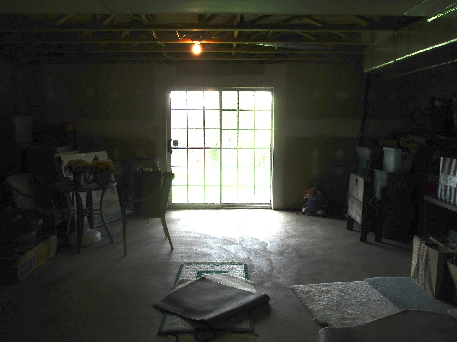

We have this basement - which is much more packed now with all our stuff. It's pretty big. I think it's 20' wide by like 30' or so deep.
You can see the walls are concrete. Can loud music or sound go through concrete like that?
I need half the basement for storage. We have a ton of crap. But, I was thinking about having two walls built. Putting up a ceiling and covering it all with this -

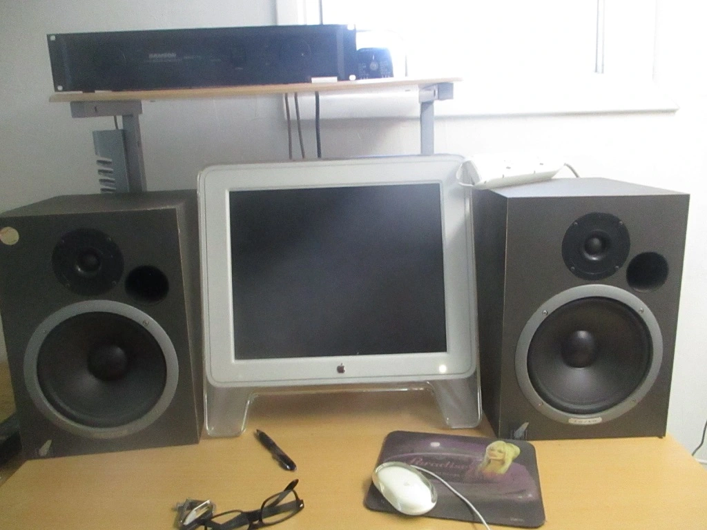

This is my "recording studio" (hoity toity ain't it) and Sony BDV-N790W home theatre surround sound system.

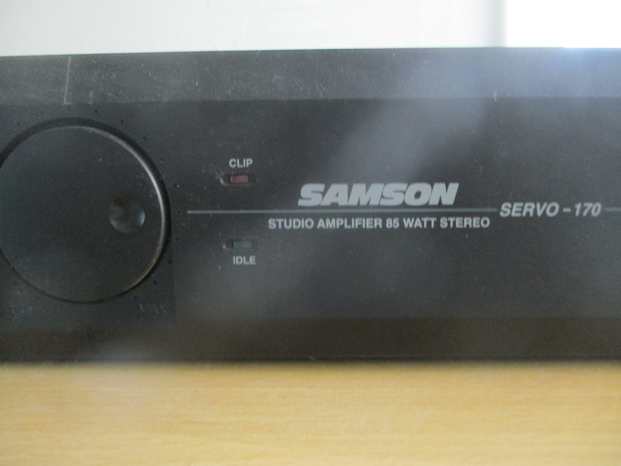

I keep the Samson at 3/4 up at all time. I adjust the Mbox and iTunes volume for comfort.

You don't get anywhere with the foam squares - Mass is what blocks sound. Also I'm confused - are you trying to stop the sound of your monitors? First thing is 3/4s up on your monitors is bad for your ears - and what does the Sony Surround have to do with the system?
I keep the Samson loud. It allows me to keep the MBox lower. But, I do sometimes blast it, usually after a mix. 50 years of loud music, I can't stop now.

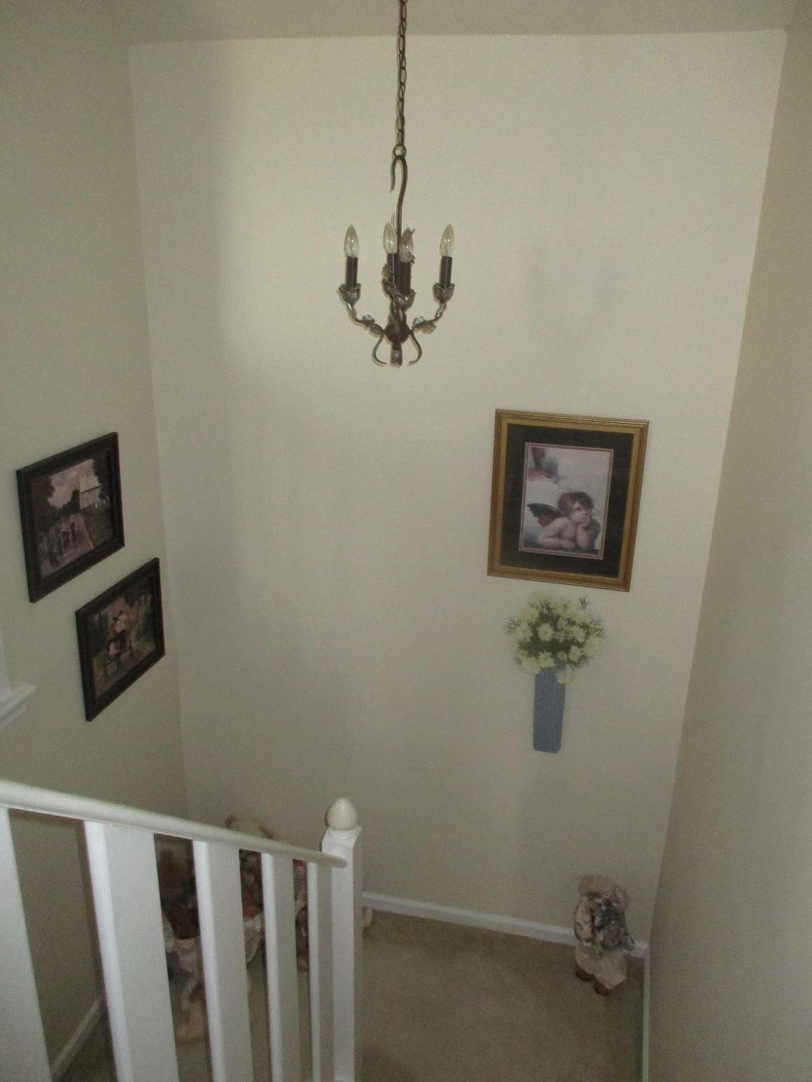

This is the attic room where I'm going to set up the movie theatre. I will not be allowed to soundproof this room, or do anything to close it off from the second floor. No construction, except in the basement. Only one of the two neighbors has a room like this. The other has attic space. So, this might be okay for the movie room. However, if the sound travels into our bedroom, I'm going to enlarge the room that's going to be built in the basement, and move the movie room down there. In the basement I could also project a larger screen. In the attic my screen would either be 9' or 12'. For a 12' screen I'd have to buy a screen. The 9' would fit on the wall that's indented where those 2 pictures and flower thing are now. Since my screen is 7.5' now, the extra foot and a half might be fine.
I also think overall the design of these townhouses considered noise. I could be wrong. But, the two photos of stairs lead from the 2nd to third floor. There's two more that lead to the first floor. Because I'm a moron with NO sense of direction. this attic room might not be over the bedrooms (at least not the master bedroom). Because I think the main space is over the stairways. I've looked out the windows and have been wrong every time. I think I should see the street and I see the backyard, visa versa. There's a skylight in this room, and I can't see where it looks out to. I can see the mountain far off.
