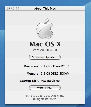

Here is the problem. I had only been able to get about 3-4 tracks at a time, with 4 plug in effects on each track, and then Logic would say "System Overload" or w/e it says.
My computer specs were:
Apple iMac 20" 2.1gHz G5, PowerPC
1GB Ram
Logic Studio 8
I recently bought more ram for it, so now I have 2.5GB ram, thinking this would solve the problem.
When I installed the ram tonight, the computer added the Ram, and it says I have 2.5GB, but my computer doesn't feel any faster at all. I opened up a project I had been working on in Logic, and sure enough, the exact same thing happened.

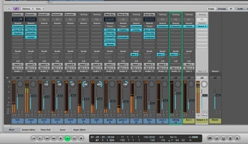

How do you have the Mac set up? Is it set up for audio only use? What interface are you using? What plug-ins do you have on each track? Are any of the plug-ins set exactly the same? - reverb the same on each track as an example. You could trim things by using the plug-in on the buss if you have the same plug-in with the same settings on each track. That would free up some of the CPU for other things.

My Mac is only setup for audio use, but it has alot of other programs on there. I only use Logic when I'm recording, as in I don't have the internet or itunes open.
I do use the Bus thing your talking about.
I will go take a picture of my setup right now (the mixing screen, and you can see what i mean)

THX's suggestion about using an aux bus for common plugins is a good one. That's what I do with reverb and echo for vocals.

I use the echo/reverb bus too.

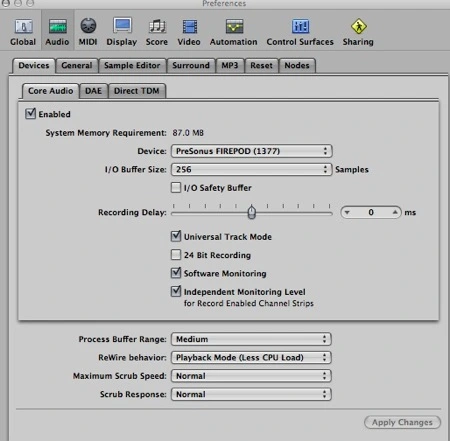

I have a Firewire Firepod, and I usually just use some effects on the guitar track, Input 1, Input 2-8 have no effects on them. Then I just get the moving beachball in logic and the light on my USB drive comes on. :rolleyes:

I'd suggest increasing the number of samples from 256 to 1024 and see if that makes an improvement.
Also a good idea to enable the '24-bit' check box

Ok, I checked the box to 24 bit and I changed my samples from 256 to 1024. Will changing my samples give me any latency?

Check the sample rate. I'm not familiar with the FirePod, but it should have a control panel that lets you adjust the rate. If it's 96 KHz, that's probably your problem. Use 44.1K unless you have a very good reason to go higher.
The larger buffer size is a good idea. That will give your CPU more time to catch up between chunks of audio.
I disagree with the suggestion to turn on 24-bit. That increases your audio data volumes by 50%. If you're already running out of CPU, this isn't going to help. Turn it on later once you get your CPU load under control.
