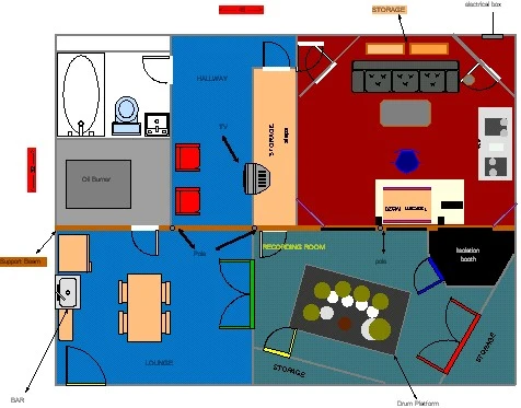

I have been trying to figure different options for my BASEMENT studio.
Like most homers, budget is the biggest consideration.
I would like it to sound & look half way decent though.
To all who may be willing to answer, please correct any errors in my plans...
Ceiling and Walls;
I'm thinking of 2x3 studs, insulation and sheet rock.
After painting I want to treat them with 703 on the ceilings and walls
mounted to pegboard like in the following pics.
https://homerecording.com/bbs/showthread.php?s=&threadid=74846&highlight=pegboard
For corner traps, I'm considering pegboard with 703 behind it, will that work ok ?
ISO BOOTH;
I'm thinking the pegboard with 703 behind it on all walls and ceiling.
I'm hoping this will work as a defusing system.
Is this wrong thinking, should I just have soft walls, covered 703 instead ?
The ISO booths floor will be ½ inch soft black rubber tile from Costco.
Control & tracking room floor;
Ok, I know that the best stuff right know is that recycled rubber flooring.
Unfortunately, even that is to expensive for me.
Carpet is the cheapest, but I know I endanger the acoustics.
After discussing the problem with my guitarist, we are considering a
FAKE floated floor.
We would take thin strips of wood, 2 inch x ½ inch, secure them to the
basement floor, cover them with pergo's blue rubber insolation,
and then finished, stained & polyurethane PLYWOOD on top.
I would then like to use this is a drum platform I'm going to build
and place on top of a 10x6 of black rubber tile and cover it with black rubber tile.
http://www.imjohn.com/DrumFloor/
I hope I'm not to far off with this plan.
ALL COMMENTS WELCOME.
Sean
