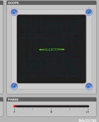

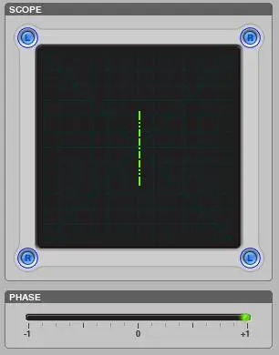

it's always looking at the phase relationship of the two channels.
The first way is it's Lissajous meter (that big green scope) and the other way is that phase meter below that.
Look at the attached photos. Picture 1 is of an out of phase signal and picture 2 is of an in phase one.
The more vertical the line in the Lissajous meter, the more out of phase it is. The more horizontal, the more in phase.
Like wise, with the phase meter and it's dot...at -1 it's 100% out of phase and at +1 it's perfect mono image. At 0 it's considered a "perfect stereo image"
