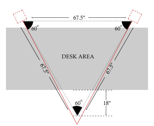

I'm sitting in front of my home DAW with a tape measure right now, for example. My Mackies are not that wide apart; the distance from the inside edge of one speaker to the other is actually only 38 inches, a pretty typical spread. If I truly wanted to put 38" between the speakers and my head while working and sitting in a physically comfortable position, I have to lean back in my chair in a way where working on my control surfaces and DAW keyboard and such would be awkward and uncomfortable. But when I lean in to actually work, because that 38" is really such a small distance, that lean in put me a good 7"+ closer to each speaker.
That 7"+ changes the angle from 60° to almost 76°. Nowhere near the 95° I sight-estimated last night, and I apologize for that mistake. But still a whopping 26% difference from the alleged "ideal". And yet my ears don't care; I can still hear and manage the stereo space just fine when I lean in to create a more than one-quarter greater angle than the conventional faith believes is necessary.
EDIT: Oh wait, I was right last night after all...
That speaker-to-speaker measurement above was from speaker cabinet to speaker cabinet. If I actually measure from the center of each woofer or tweeter to the center of the other, the distance is 46" That changes the angle at my lean-in position to some 95.7°. A whole 60% difference. It turns out my eyeball estimate last night was almost right on. And If I were to sit 46" away from the speakers, I could barely reach the DAW keyboard.
And I will bet that what I have, pictured below, is not that different from most folks out there who have never had a problem with panning or sound either. I have upgraded much of the equipment since this picture was taken some 11 years ago or so, but the speakers, the desk and the positions of both of those remains the same to this day:
So when the difference between sitting back and leaning in, or from the speaker cab measurement to the center-of-speaker measurement can make a 60% difference n the actual physical angle and not make a difference to one's ability to work, I'd have to say that the real live evidence supports what the math says on paper, in that the 60° angle idea is arbitrary and meaningless.
EDIT2: And now that GL has confirmed that changing his angle from 80° to 60° has made no real difference (below), there is independent confirmation of that fact.
G.

Now...just to clarify, since you seem to be stuck on the 60° thing.
There are two angle considerations...
1.) The three angles of the triangle, which have to be 60° each IF you are going to use an equilateral triangle to PLACE your two monitors and your seating position.
2.) The angle for the toe-in/out of the speakers at the apex of the two points of the equilateral/60° triangle. There can be a few degrees adjustment to the toe-in/out as per personal taste and to aim the speakers in front of you, at you, or right behind you.
Here's three images that show these options:
Those are the *optimum* placement choices.
The distance of 67.5" was not my own, but something I got from Carl Tatz Design (http://www.carltatzdesign.com/) ...he was/is adamant about the 67.5" sides, with exactly 30° toe-in of the monitors, which places them right ON the same lines as the equilateral triangle...or if you measure their angle from "inside", they are also at 60° angles (60° + 30° = 90°)
...but as it turned out, after a few different setup tryouts, I ended up with 60.0" sides, BUT I used the third image setup --- I toe-out the speakers by a few degrees...so they end up firing at the same spot as if I had used 67.5".
I ended up with this purely from lots of trial error, moving things by a few inches and a few degrees, and using my ears.
Anyway...these optimum positions provide the best image --- Left/Center/Right & Front/Back. I don't need math to prove that...simply try it and hear for yourself. I have, and obviously many others have, which is why the equilateral triangle setup has become the tried-n-true choice for nearfield monitor positioning.
Can you still "hear" stereo with some whacky w---i---d---e spread and very hard toe-in…? :eek:
Sure...stereo just needs two sources, basically…but that's not going to give you the best image from the monitors.
Also....the further apart you go and further in you sit in-between the monitors...you totally fuck up your listening sweet spot. One little move in any direction, and your image falls apart a lot easier/faster....
…which is another reason the equilateral triangle setup just.............works. :cool:
