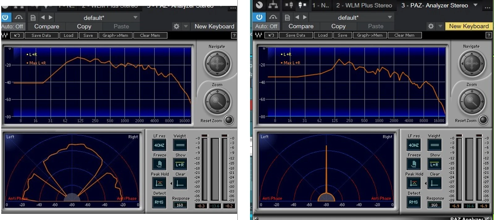

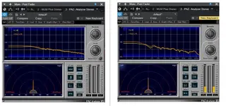

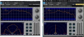

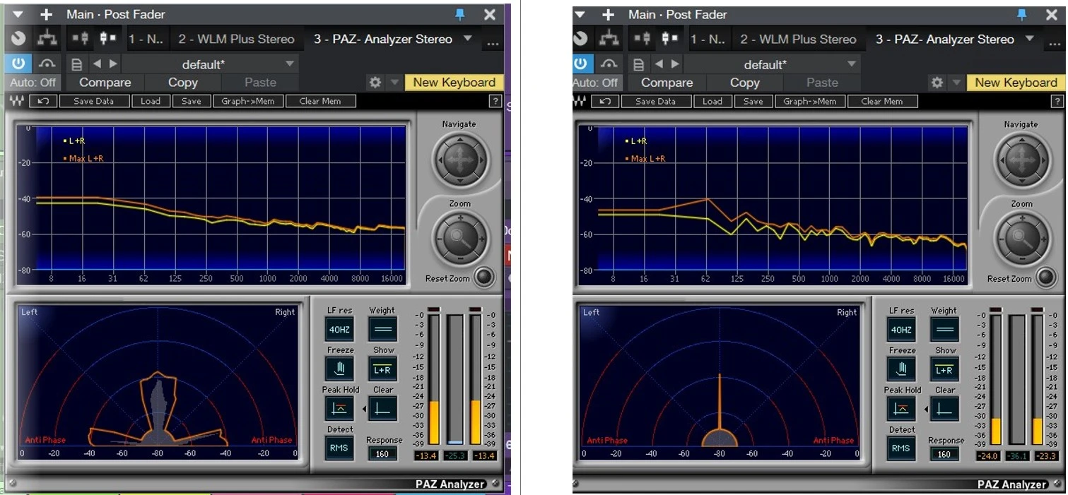

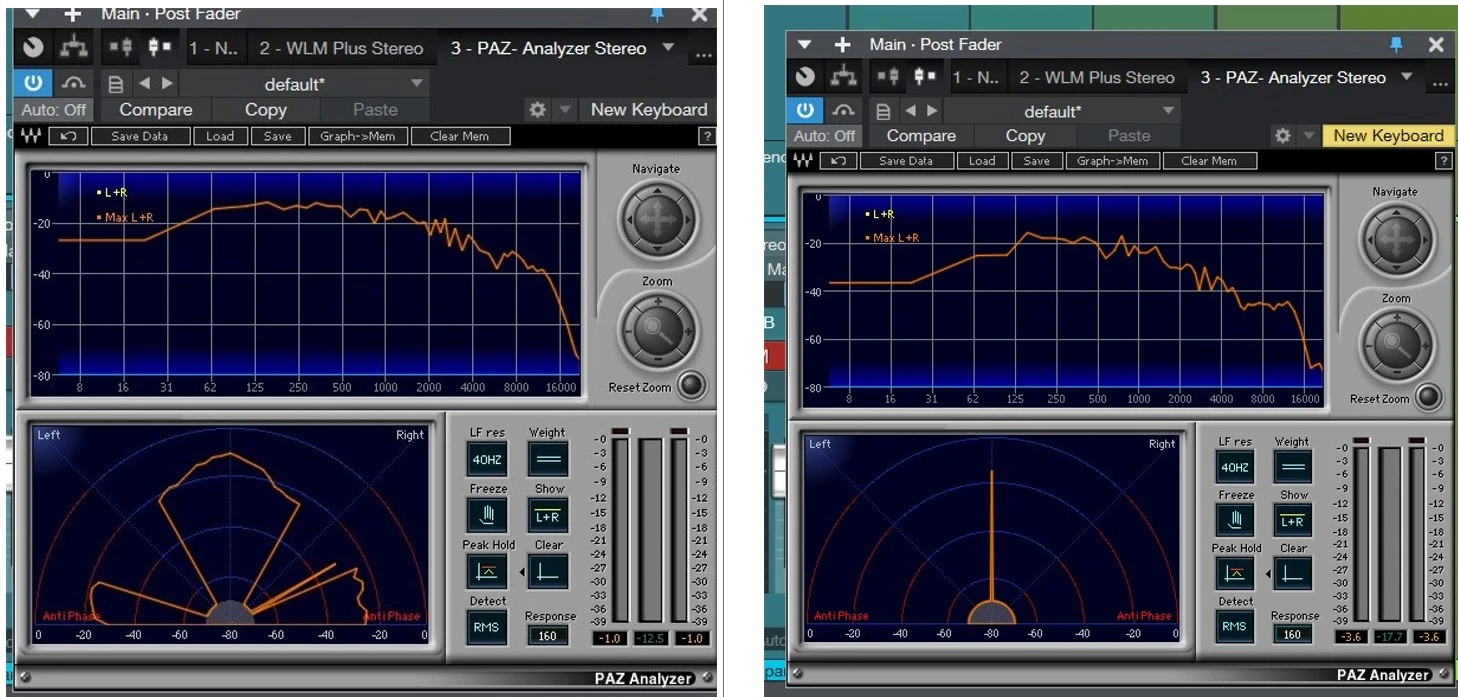

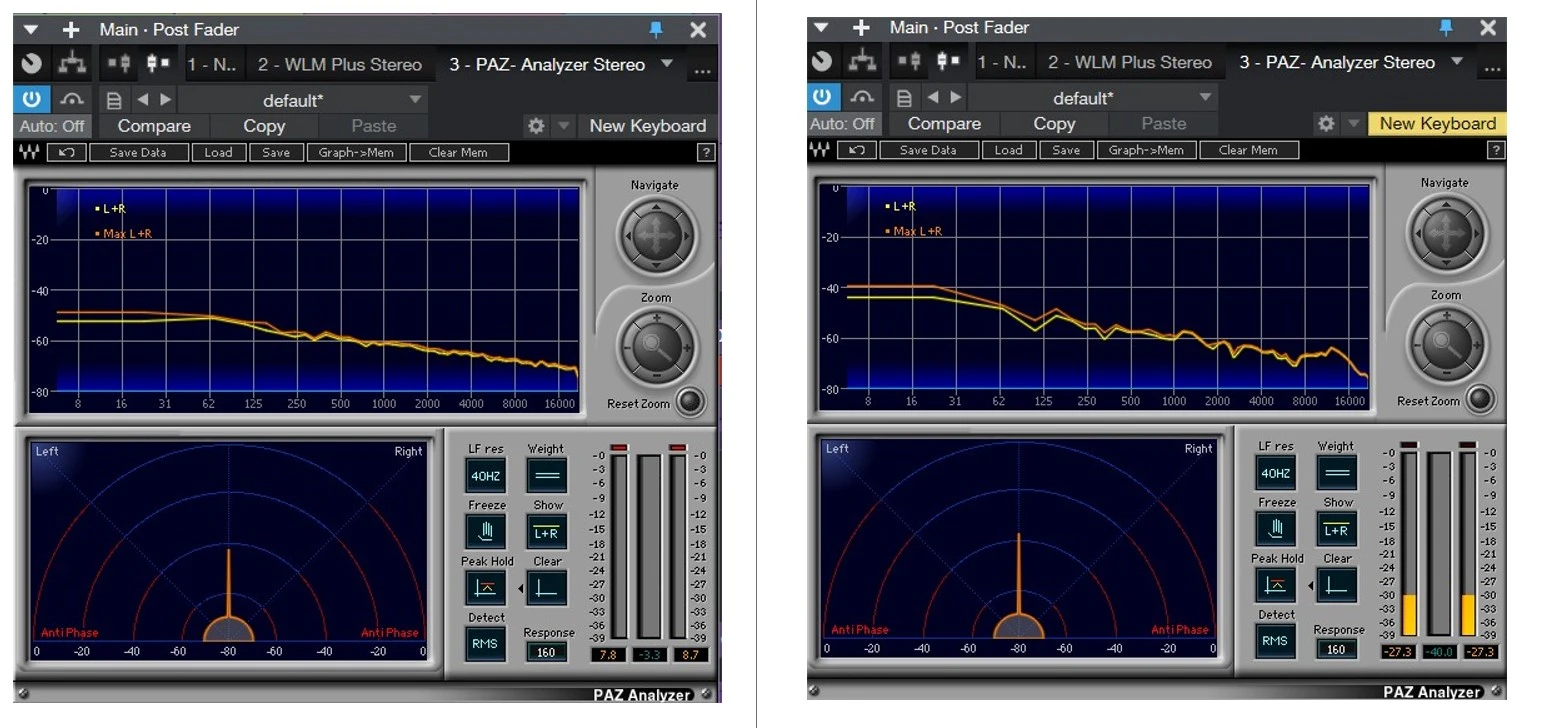

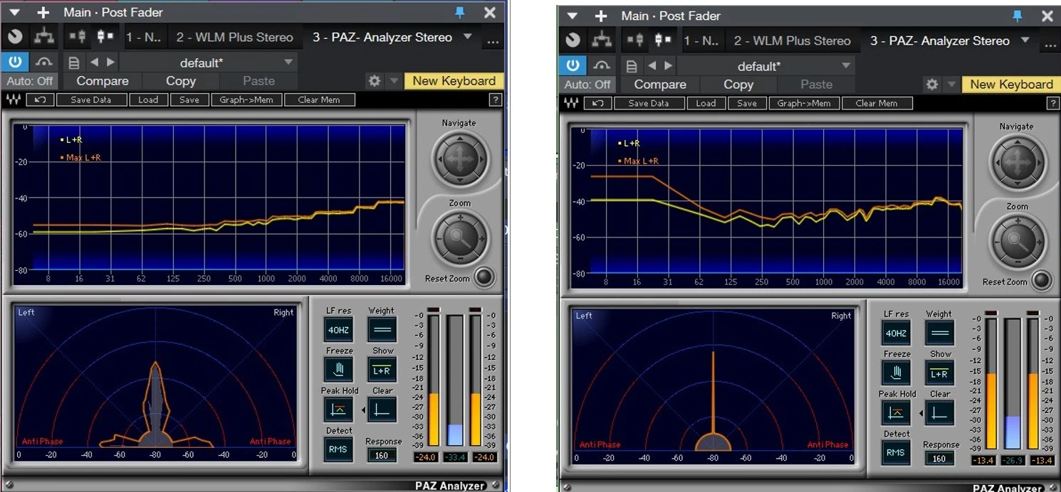

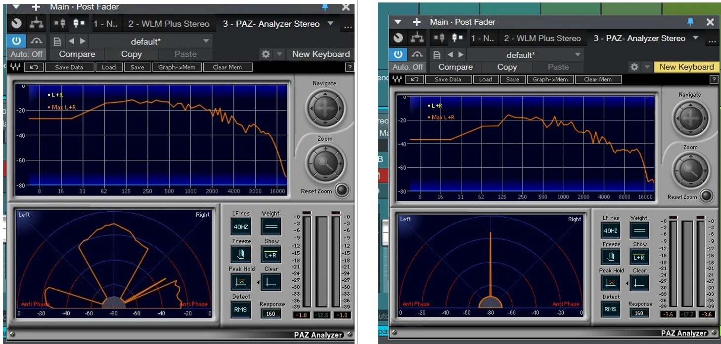

Now, bare with me here...I've done something highly unorthodox...but I hope it may shed SOME light on things here.

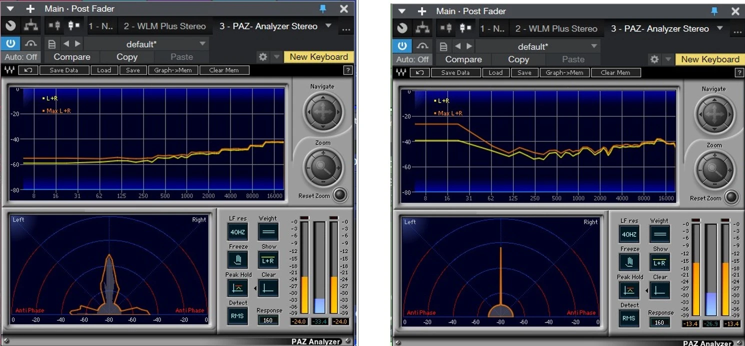

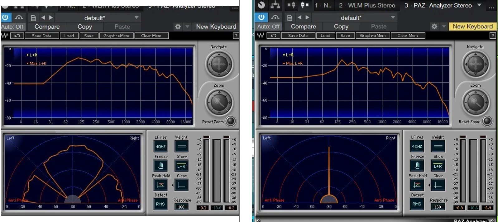

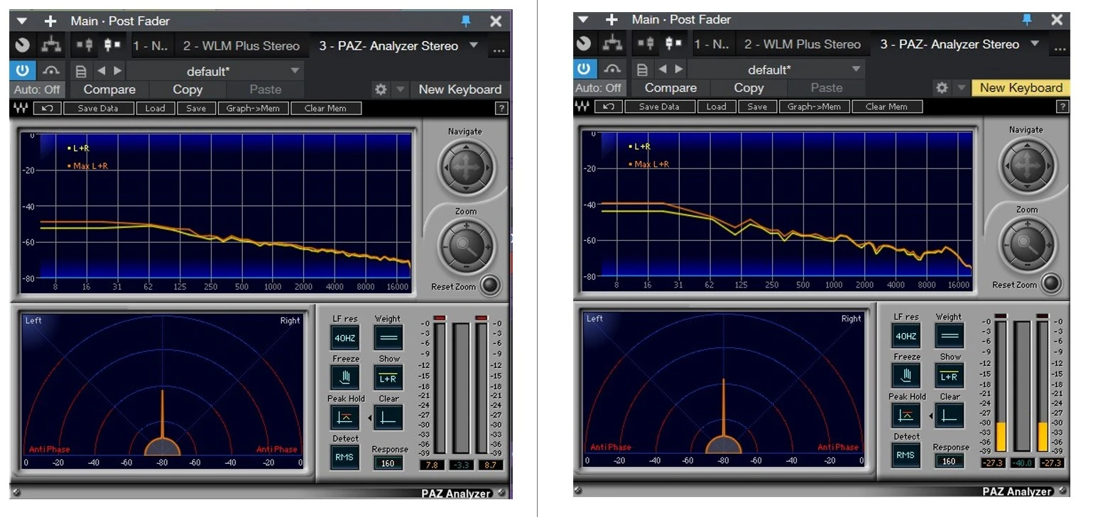

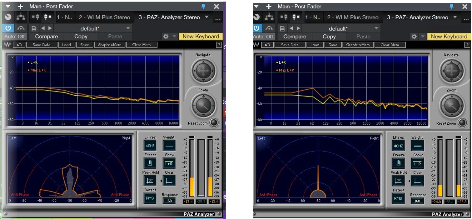

What I've done is a poor man's frequency analysis. I played
a) one of my songs, a Beatles song (I'm So Tired), an eq sweep, white noise and pink noise...
b) I played all these...the songs in full and the tones for 30 seconds or whatever...and I measured the overall frequency response using a plugin.
c) Next, I got my Behringer ECM8000 measurement mic and placed it right in the listening position
d) Then I played back and recorded all the above mentioned songs/ tones
e) I then played back those files in full and measured the frequency response to see what my measurement mic was roughly showing me in the listening position.
This was not a scientifically accurate exercise...just a rough idea. I'll post 5 image sets here. The 1st frequency graph shows the original frequency response in the DAW. The second image shows the frequency response recorded in my room at the listening position.
Naturally, there's obvious differences. Keep in mind, I think it's better to concentrate on the shape of the response...not so much on the volume shown (though I know that's crucial too). I think these graphs show where problem frequencies may be in my room. Of course, you'd have to accept that the Behringer ECM8000 is decent enough. But even still...just as a very rough comparison, I think it's clear I have problems...separate problems from the wealth of problems I have in general. ;)
The images from L to R are:
1. The EQ Sweep
2. I'm So Tired
3. Melinda (this is my song)
4. Pink Noise
5. White Noise
The 2nd of the images is the one recorded with the measurement mic in the listening position.
It's interesting...and confusing that in the tone generations my room seems to be showing too much bass response...but in the 2 songs not enough bass response.
So, I remain utterly baffled.

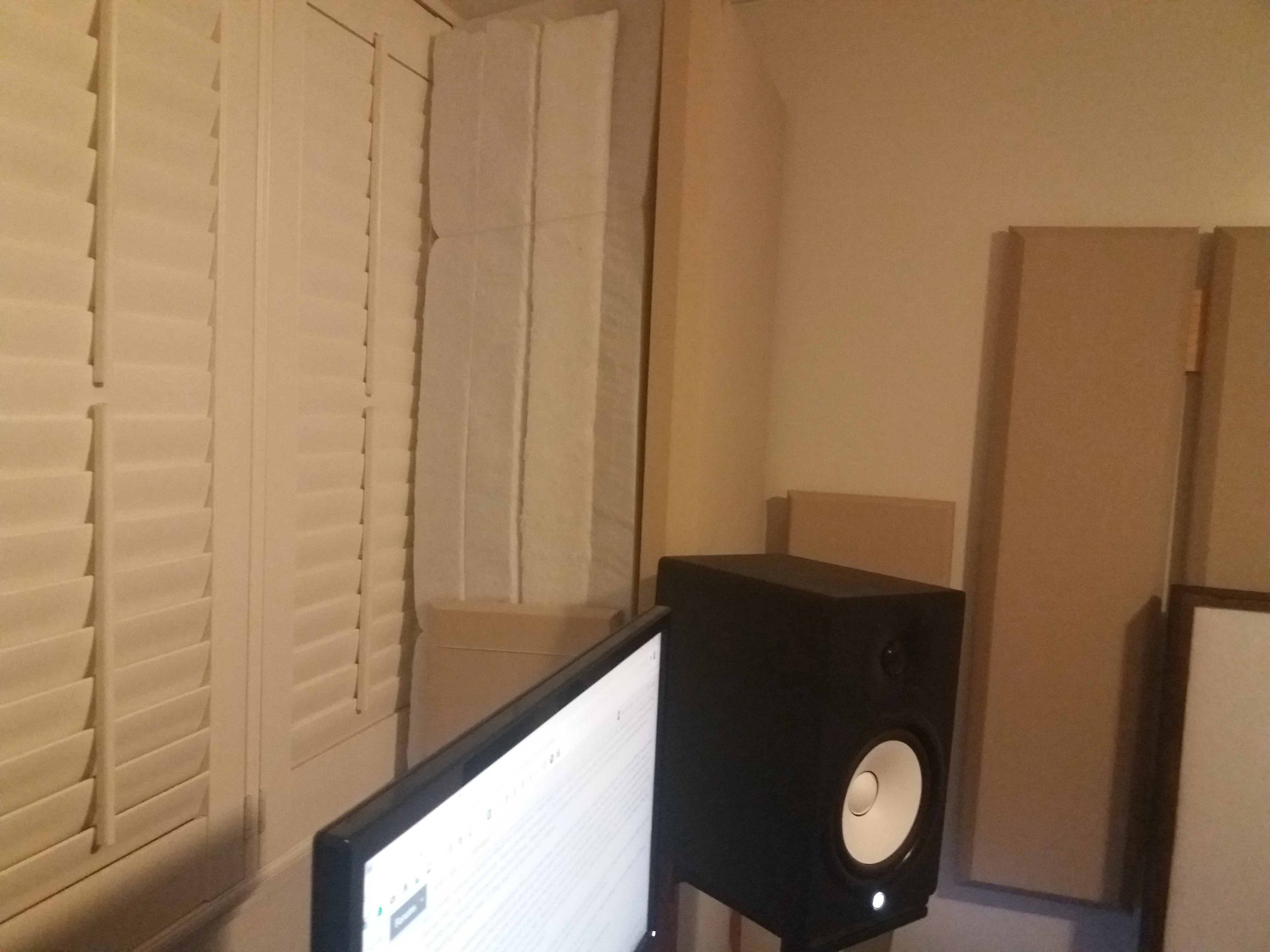

Now, as far as your treatment and listening position from your photo there, there are some issues that are misguiding your judgement. First off, those Prime Acoustic panels are high density fiberglass panels that are good for absorbing mid and upper frequencies, but actually reflect lower frequencies. What is in your DIY bass traps? How are they constructed? Your speakers are very close to the front wall and corners, so you are in likely the worst place you could be to have any sort of accurate representation of what your low end is doing. Nothing you have for treatment there is helping you at all under probably 400hz. I realize most don't have the space to properly treat for low end, but the fact that you are tucked into that wall right in the corner is going to make things really hard to accurately know what you are listening to. Even if you could get those monitors off the front wall a couple feel would possibly help. Ideally you want your listening position at 37% of the length of the room. Not typically possible in a small bedroom size room I know. You stated that your monitors are placed well off back wall. I assume you meant front wall? In the picture you posted it appears they are almost right against the wall. Is that maybe a picture of an earlier layout?

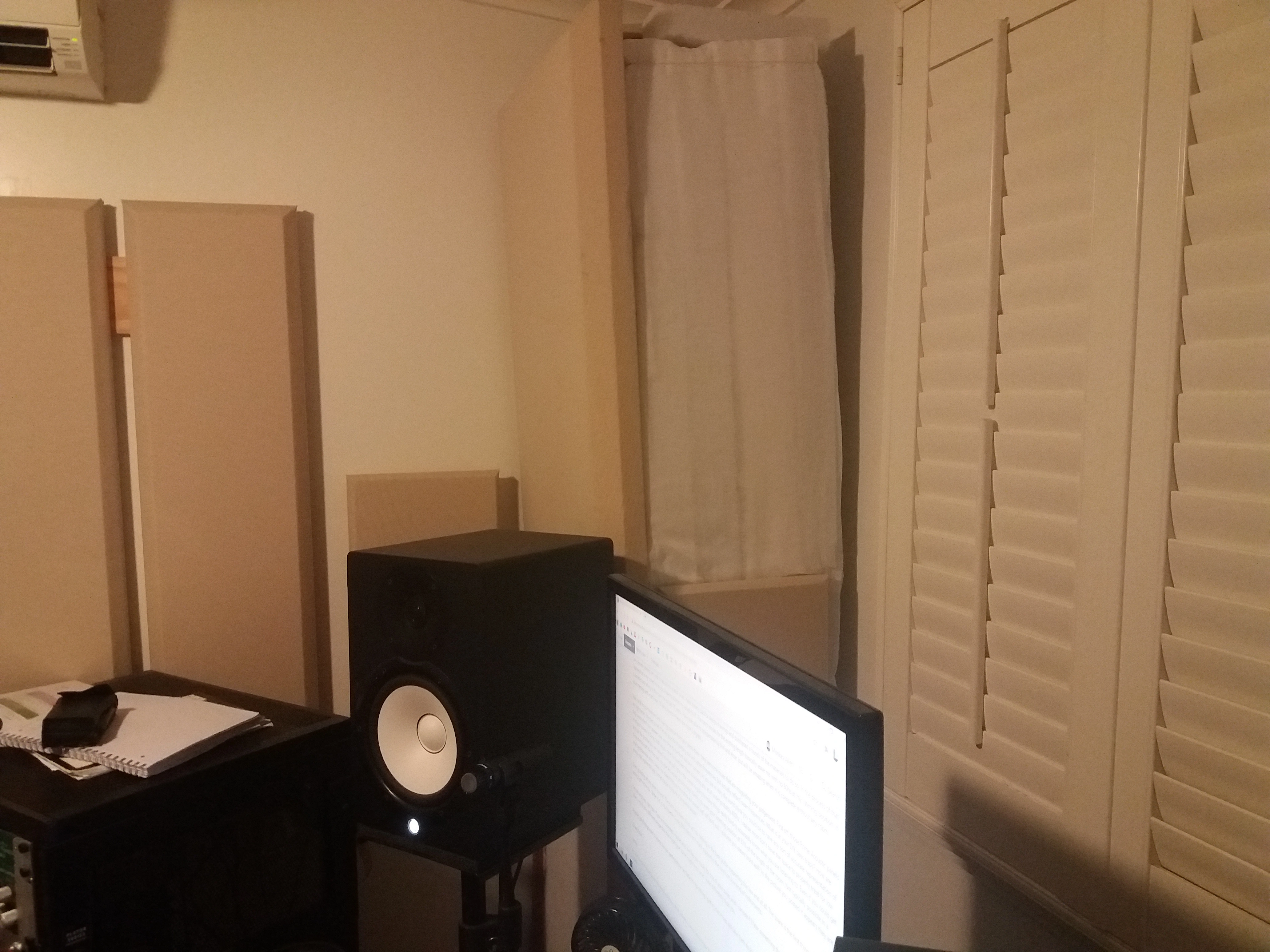

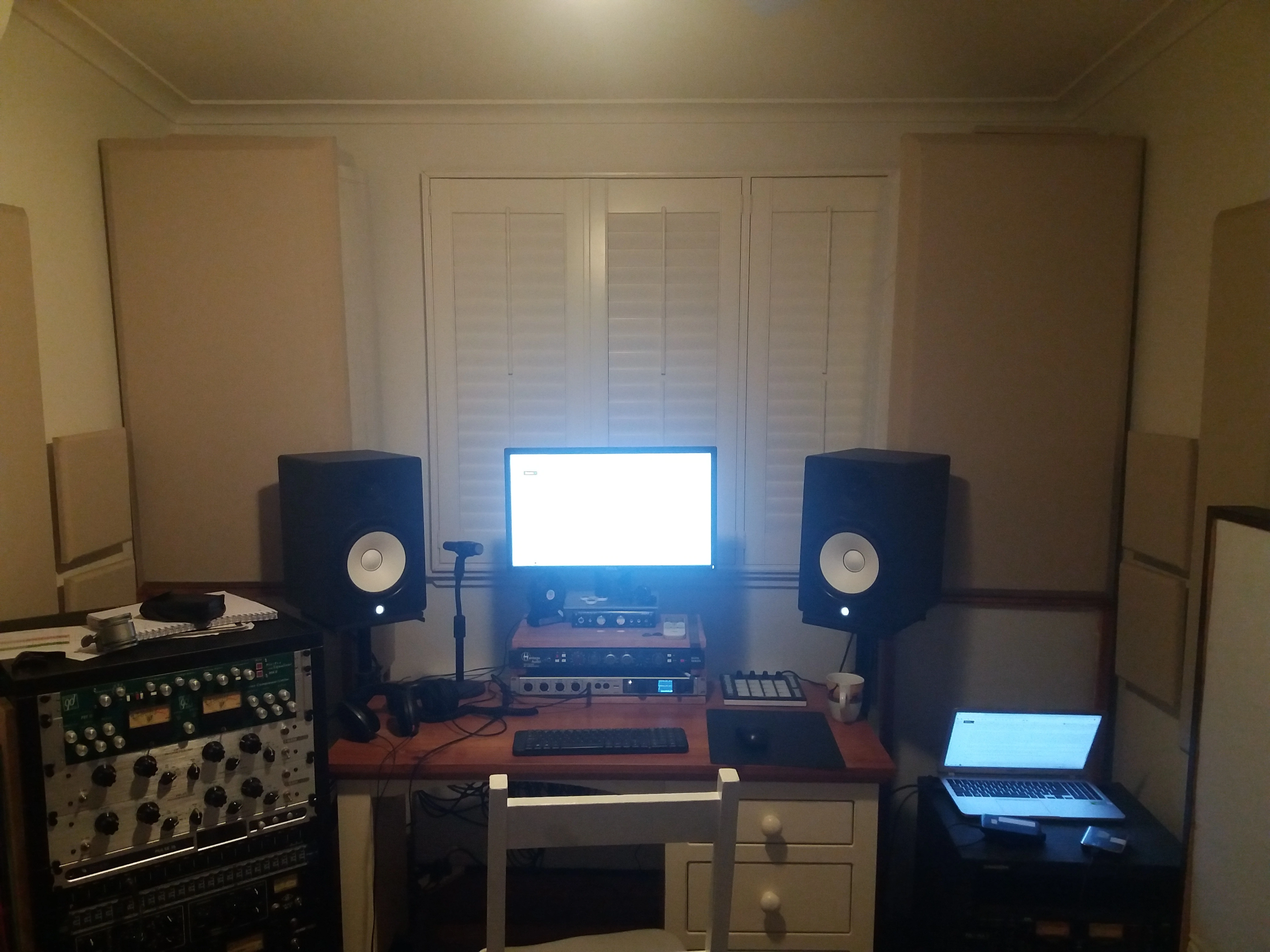

Thanks Jimmy, very useful advice. I wanna talk about some things you said but first on the speakers and the treatment. I', gonna attach 3 pictures that show the setup more clearly, I hope. I'm not really in the corner of the room...as you can see...it's something of a horror show...the room is small but my listening position is as good as I can get it...I went for that 37% concept. Also you can see that the speakers are roughly a foot and a half off the back wall. In each front corner behind the speakers I DIY'd acoustic polyester "bass traps" which are 2 feet wide and 40cm deep. They go from floor to almost ceiling. Now, to be honest...I simply have not been able to find stuff like Owen's Corning 703 or 704 or whatever the good stuff is. So this stuff that I've used is stuff recommended to me somewhere down the rabbit hole of room treatment. I'm the first one to admit it's not the best stuff for bass treatment. But it's literally all I could find in Australia.
What you said about the PrimeAcoustic stuff, yeah, I agree...I bought the London 10 kit 4 years ago, plus two of their 3 inch bass traps (these are sitting on the front of my DIY corner bass trapping)...and sometime after I bought it I read somewhere that "oh that PrimeAcoustic stuff is great...great if you want to treat the waiting room of a dentist". In other words...it's simply not good. It'll do something...just like you said...but it won't solve my issues.
As far as Luke Fitz and his songs...man...I'm his biggest fan. He's in Australia too. I contacted him some years ago just blown away by the songs he writes. I was trying to pick his brain but he wasn't into talking about his processes. He actually recorded a cover version of one of my songs. He's a mega talented muso...plays drums, guitar, piano, sings great, bass etc. In my eyes the guy's a freak...incredible songs. As for me...I'm more a plonker. I won't kind of go down the "wo is me" thing, but hey, you know, I know my limits musicianship wise, and I'm ok with it. I just strongly believe that I CAN record and mix my songs so they SOUND sonically fine, regardless of how good the songs are. Hell, there's a million songs on the radio I don't like that sound fine.
As for rolling off more low end...actually, I often use an eq on the master and I bump up the low end from 100hz or 12hz or so...bump it up by 1 or 2db, trying to get a fuller sound. But maybe my room is telling me there is plenty of bass...and that's why my mixes are bass light or something. Not sure.
And the bass being bland...well that's a Fender P-Bass! I thought they were supposed to be pretty cool. But yeah...I've been underwhelmed with it. Recording DI (and this is across the board with anything I track...which is all in this room) is lifeless it seems...especially the bass guitar just seems to be a wash of low frequencies where notes are inarticulate...kind of boring. I can say the same about recording vocals or acoustic guitar (not in the low end wash so much) as in the recordings seem bland. I just don't know how I excel in achieving this with the sweet gear I have.
As for the sub frequencies...well yeah, like you said, the stuff I do, I don't think, is sub bass kind of stuff. What I sometimes think of in terms of overall sound is something like The Ballad of John and Yoko...just a great recording. The bass is rich and deep and everything is just so nice. That's the kind of blend I try to imagine. But yeah, as I said, my tracking tends to be very bland. That might (probably is) me and how I sing, play etc.
And man, your offer of a mix...I'd love to take you up on that. I could send you the tracks. Is there one you reckon you'd be interested in? How about Consecration Day? Or maybe Company Stranger? That's relatively straight forward, not too many tracks, so it might be better. Up to you. And also, if you get my raw tracks and listen to them and your feeling is "hmm most of this stuff needs to be re-recorded, it's just not mix ready"...then tell me straight up. Because that's an area that likely needs a lot of improving...the tracking. But, if you're up for it, sure, I'd love to send you a song to mix. Thanks dude.

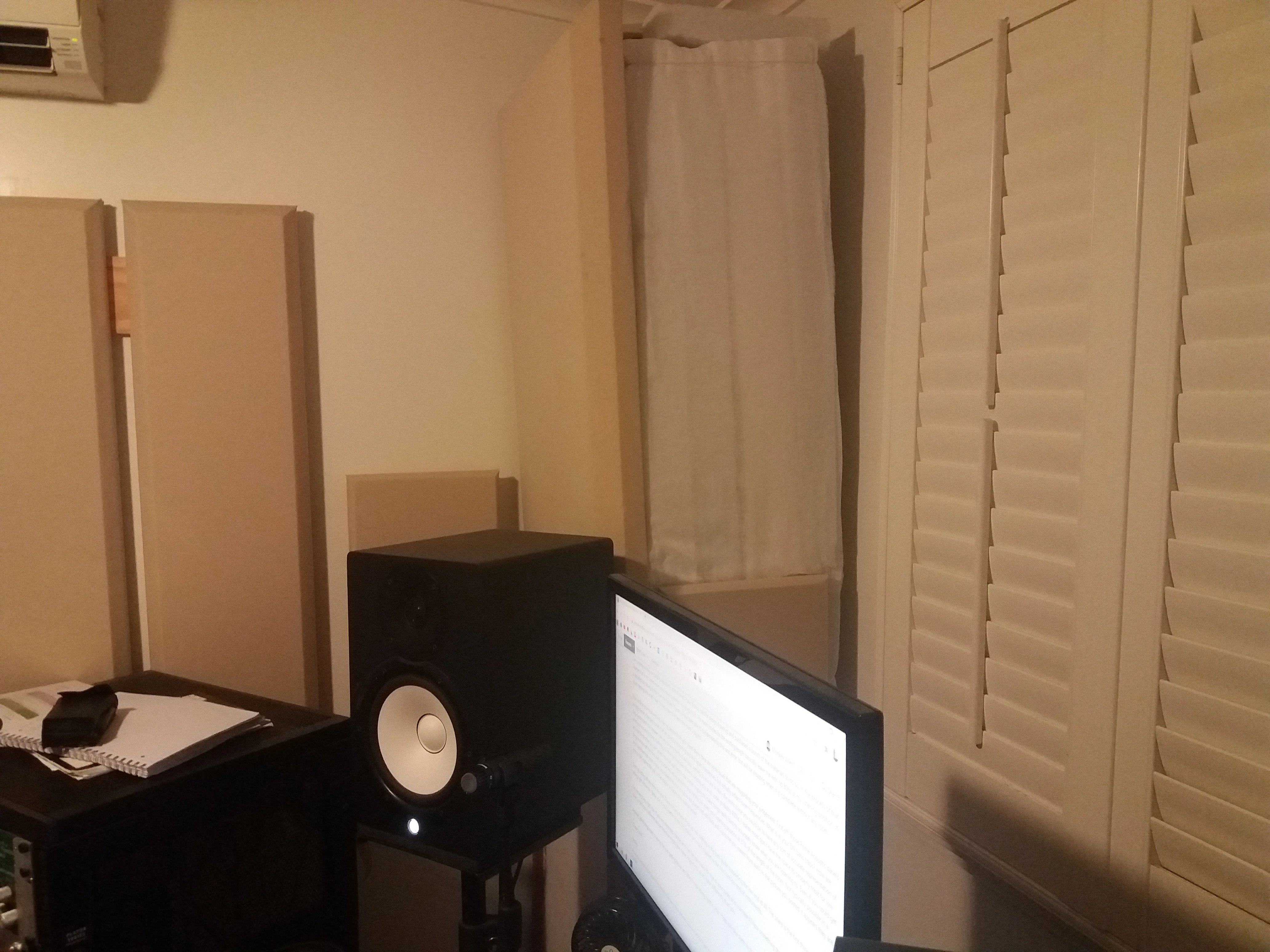

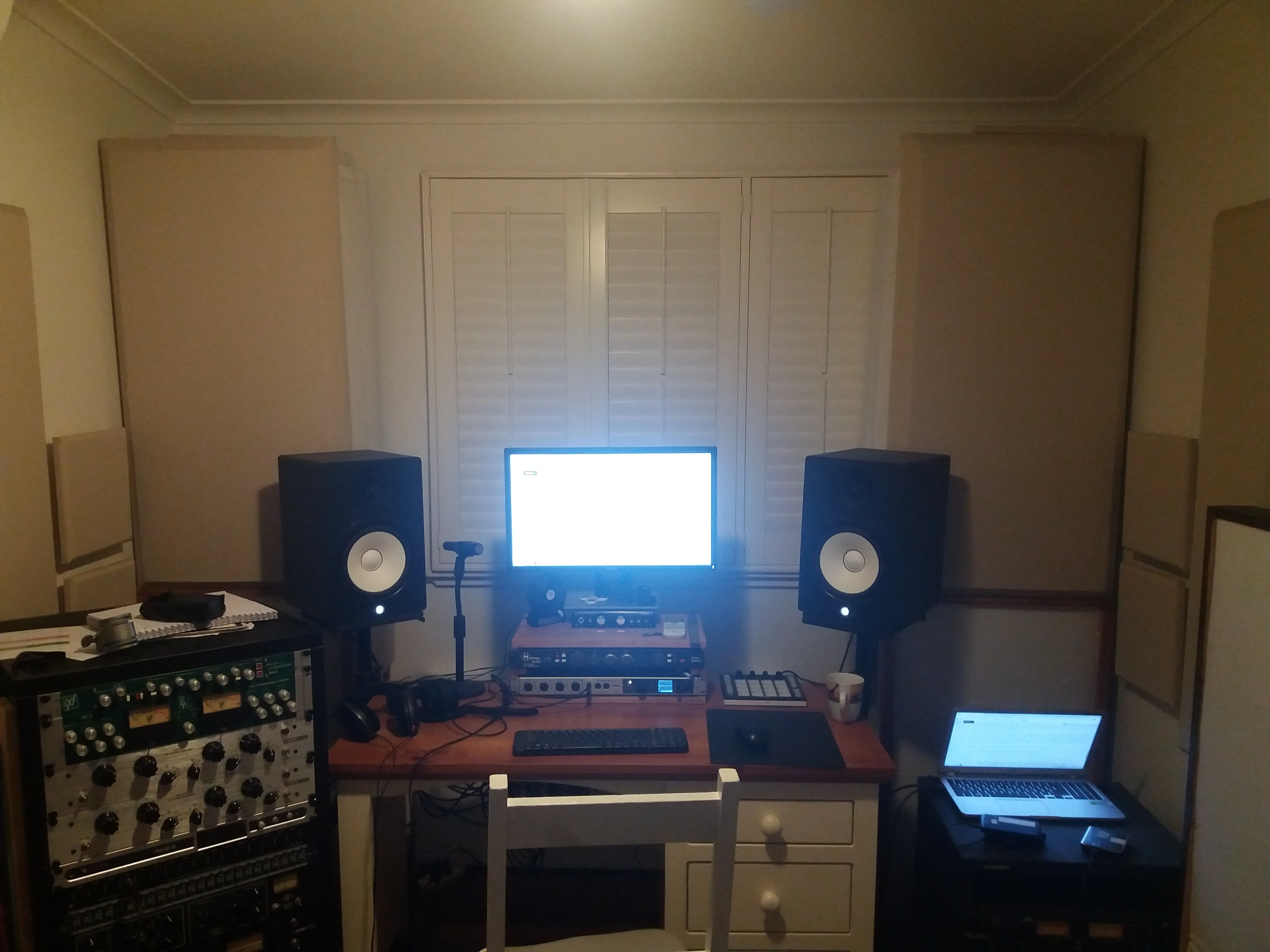

Here's the pics I spoke about before...

Cool! Those pics definitely show your position much better.
So for treatment there, in that corner I would do away with the Prime A panel at the corner as they are reflecting low frequencies. The polyester isn't doing anything. You want to use the easy to find/inexpensive pink fluffy stuff man. Limp bag absorbers with loose layer in front are your best bet. If you are handy, I would suggest you build yourself a simple pine frame the same 16" ish square space you basically have there. You just need to stack the rolled sheets vertically so they don't sag. The back 10" you need to seal completely in 2 mil plastic. It does not have to be pretty, just sealed. Plastic trash bags could work, or you can use a plastic sealing tool. I have heard that even just using packing tape will work, though sounds pretty cheesy... In front of that 6" of un-sealed insulation covered by easily breathable polyester cloth.
That is the basic principle of the absorption that will be used in my control room build designed by JH Brandt. Though mine also is on all walls and ceiling, plus specially designed membrane traps on front/back walls and diffusers in the rear.

You said your room is like 16'x13', but those pictures don't look like that - looks maybe 9 feet wide at most. and those monitors are kind of close together - 3 feet? Your listening position should form an equilateral triangle with the speakers.
You're dead right. My mistake. The room is 8 feet x 11 feet. And the monitors are roughly 3.6 feet apart, with me roughly in the connecting triangle, I guess.
So yeah, just send me all the wav files for a tune of your choice to angellicrage@gmail.com. I'm not concerned about amount of tracks. My current mix project has 30 or more...
I'll have a listen and be straight up with you. You aren't paying me so I have no desire to bullshit ya. LMAO!
Ok, I'll take away the Prime panel behind the speakers for a start and look into the pink fluffy inexpensive stuff. If you can easily find a link showing the kind of stuff you mean, please send it. Thanks. PrimeAcoustic market those 3 inch panels behind my speakers as "bass traps"...so...kind of deceptive there. But I'm not surprised.
