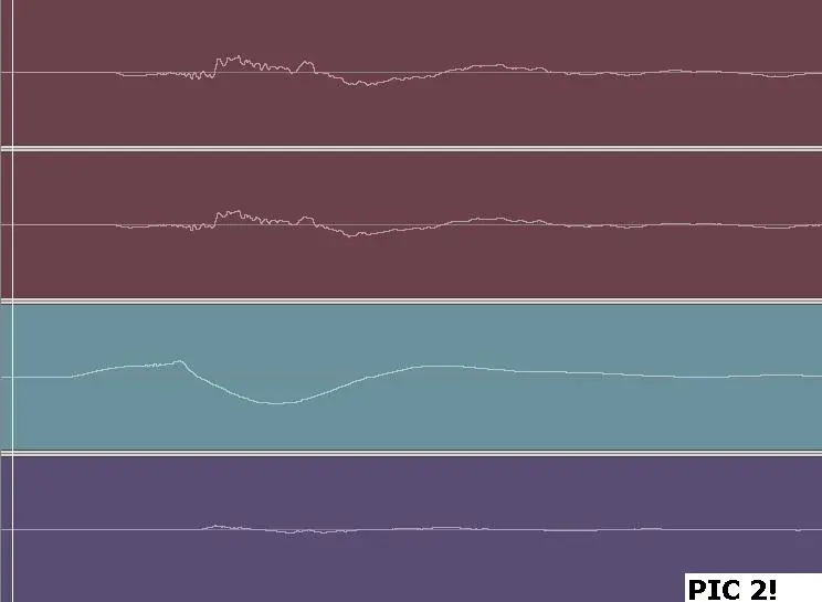

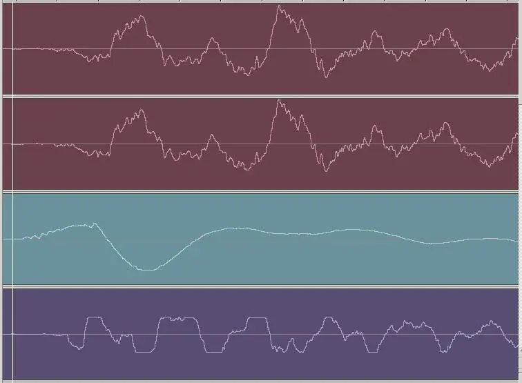

close up
PIC 1:
here's a close up of the 4 drum tracks I got.
L overhead.
R overhead.
KICK
SNARE
This is a close up of the main part of the kick, but also being played is a snare roll....with little accents on the kick hits.
The second picture is another band I recorded...same 4 tracks in the same order. However, this is just a kick drum hit, alone.
What can you trell me about this? I really don't know think it's very off...should I zoom closer? HA!
