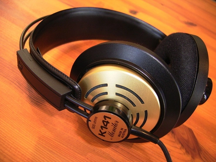

The "headphones" like shown below......
ex: AKG K141 600 ohms
You may need to look at the instructions/specs for the ohms rating.
