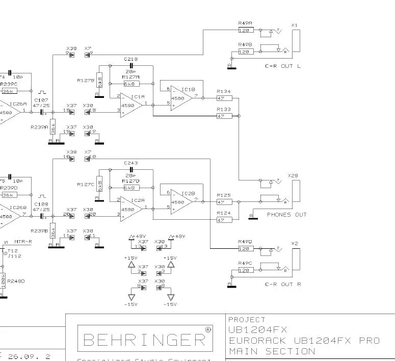

I've got a Behringer X1204USB and a HA400. Just hooked it up to a line out of my PC to the stereo ins 5/6 of the mixer and gave it some signal from an mp3. After setting a couple switches and levels I got clean audio in the headphones from the HA-400. I think it may be a bit different than your mixer as far as the output circuitry for the headphones. I have a service manual for the the UB1204FX and it uses an OP Amp to buffer the signal from the parallel control room outs, but possibly with out normal loading from the headphones maybe could develop a signal voltage that could overdrive the headphone amp.

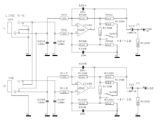

The combination of the line out on the computer into the stereo line ins of the 1204 does something a little odd and does exhibit some distortion for a given setting of the +4/-10 level button and it's not because of signal level. The line inputs of the 1204 are direct coupled and will pass DC voltage to the OP Amp in the front end. My computers line out jack for what ever reason has a DC bias voltage on it (I think it has something to do with the computer soundcard sensing what gets plugged in). This DC from the computer finds its way to the mixer and being direct coupled gives the OP Amp a DC offset from zero, offsetting the signal peaks to have less headroom and causes a distortion of the audio. The occurs when the -10 is enabled with the switch, but not with +4 which appears to lessen the effect of the DC offset by altering the OP Amp gain and headroom.

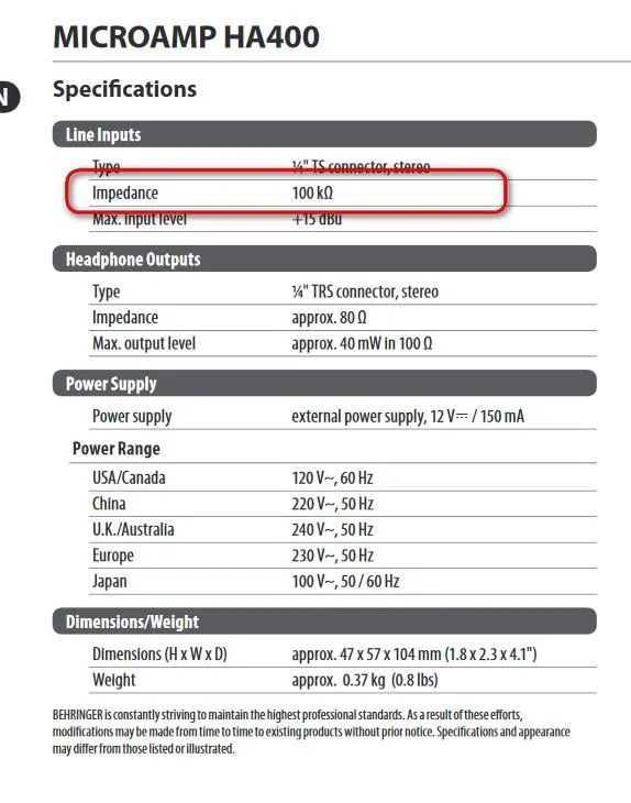

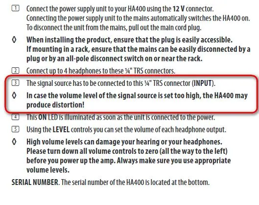

I'm sort of the belief it may be an issue with the HA-400 not loading the headphones output enough to keep the signal level down. The mixer headphone output OP Amp is operating off +/-15vdc and the resistor on the output of the headphones jack is 47 ohms. The signal swing could conceivably reach close to 15v peaks with the 100k ohm load of the HA-400, which may overload its frontend. The manual for the HA-400 seems to mention its input as being a "Line" source, rather than from a headphones jack.

Sorry Mark but that does not compute! The output of the HP opamp will be almost perfectly regulated and not need loading. In any even a load of 47 Ohms would be needed to produce just a 6dB drop..IN THEORY! The op amp's output would collapse for a load less than several hundred Ohms if a "decent" chip such as one of the NE55xxx family and if a TL0XXX it would cope with only a few k Ohms.
X1204USB mixer (may be a bit different than the the OP's mixer, but similar)
- Set headphone output to 2.00 vrms (about 10 o'clock on control) no load
- Loaded the headphone output with 100k ohms (approx. HA-400) > 2.0 vrms measured
- Loaded the headphone output with 33 ohms (approx. most headphones)> 1.15 vrms measured
Yes, at the OP Amp the output would likely be relatively constant/"regulated", but the resistor in line from the output of the OP Amp to the headphone jack causes a drop, thus the variance of output for external loads. Kinda just hinting at the OP may be not turning down the output of the headphones on the mixer to accommodate the change in output from different loading.
